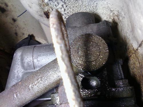

Finally got my 74 MGB out of storage and it seems to have developed a leak on the drive home. I assume its the front shock absorber as there is mineral oil all over the ground. It seems to be coming from the arm (I have attached a photo). Please correct me if I am wrong however.

Indeed a leaking shock. I'd recommend that you remove both front shocks and send them off to Peter Caldwell at World Wide. You can find his contact info in the Directory on the left side of your screen, and he is a long-time and respected member of this Forum, and also pretty much the source for refurbishing lever shocks. You'll find many, many satisfied customers here on the MGE.
Might-as-wells include rebuilding king pins and replacing bushings. Some prefer stock bushings, some prefer poly. You might also replace sway bar links and bushings. Do a search and check the library for more info. All depends on how well it rides and how deeply you want to get into the front end. Unlike the rear leaf springs, front springs often do not require replacement unless there is noticeable sag in the front end.
