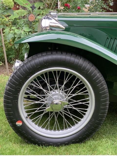

I have Blockley and saw on a lot of other MG’s and Bugatti this tires. I think a very good quality, they have the correct rim bands and tubes too.
Franz
