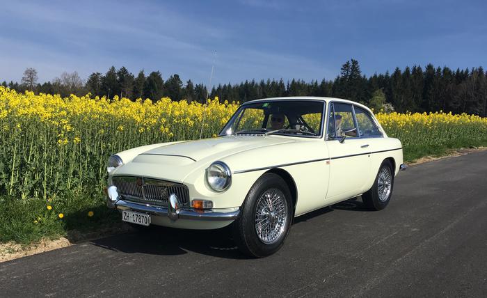

Hello friends
After a long pro and contra, my MG CGT just won the MG 50th concours at Chateau Impney GB, I have decited to go for the EZ power steering.
The result is phenomenal! It transformrd the car into a easy to use every day car!
You know the haevy steering in shopping centres, but there is more advantage on twisty roads: finally I can drive trough hairpins with one hand on the wheel and the other hand changing gear! Just great!
I have ordered directly from http://www.ezpowersteering.nl/ and it cost me 1500 Euros + some freight and it arrived next day!
The installation is straight forward and the electrics are easy. Once properly fixed, it is hardly visible from the drivers view. There is a little problem with the diameter of the pin going into the X connection. This should be solved by now. I am glad to give you any assistance.
