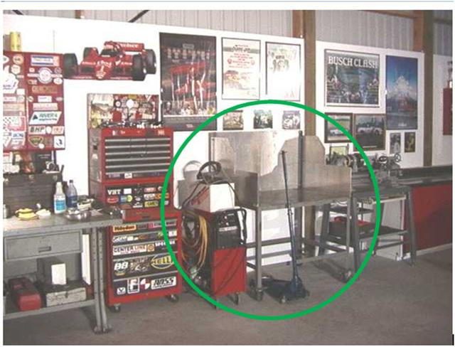

I have successfully been using a 120v Lincoln 125 Plus 90a wirefeed welder for 15 years. Lincoln .023" wire (I don't care for the HF wire), Argon/CO2 cover gas, 30a breaker. The first home project was the rolling welding bench with a 5/16" top surface.
There are some tricks to increase or decrease weld penetration besides adjusting the machine:
- Weld downhill to decrease penetration, uphill to increase penetration.
- Straight CO2 to increase penetration, straight argon to limit penetration.
- There are various argon/CO2 mixtures available. On sheet metal I use a 90% argon/10% CO2 mixture to limit burn thru.
- Longer wire stick-out to limit penetration, shorter wire stick-out to increase penetration.
- Increased cover gas flow to limit penetration.
- Chilled copper backup bar to limit penetration.
- The longer the extension cord (10ga) the less penetration, yes my 30' extension cord will get warm when welding wide open.
- Flame base metal preheat to increase penetration.
- Multiple pass Vee-groove welds with preheat on thicker materials to increase penetration.
Be safe out there.
