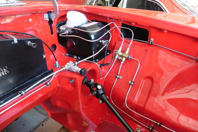

Kevin,
I manufactured the complete brake and clutch system for my GT plumbing using annealed stainless tubing and the Eastwood flaring kit. Not cheap ($200), but superb quality. I will use it for the MGC when that time arrives, hence my investment...

Same as mine. DAMN Good tool. I have three of the other "HORSE SHOE %^&*90 " Clamp type ones.
DO NO do the HF one for sure. smileys with beer
