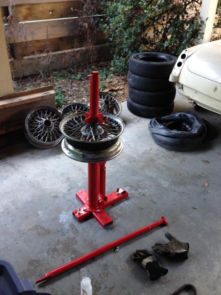

Harbor Freight sells an inexpensive bubble balancer. It worked very well for me. Of course, I had to buy their portable tire mounter, too, because I couldn't find a shop to mount the tires on the wires, either. That also works well if you are willing to sweat a bit, and can bolt it to your floor.
