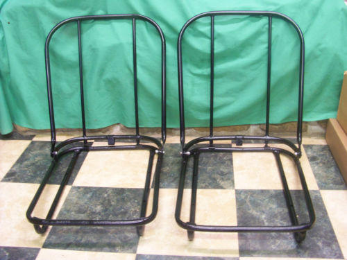

Here is a photo of actual EARLY MGB seat frames (#1). They differ on the seat bottoms due to the difference in the shape of the trans tunnel in the early cars compared to the later cars with the slightly larger 4 syncro trans. From 1968 (and perhaps a little before) the seat frames became truly "handed" as the inside sides of each seat tapered to accommodate the wider tunnel (Photo #2).
Photo #3 is the late model seat frames and perhaps you can see the handed taper introduced more clearly in that photo.
