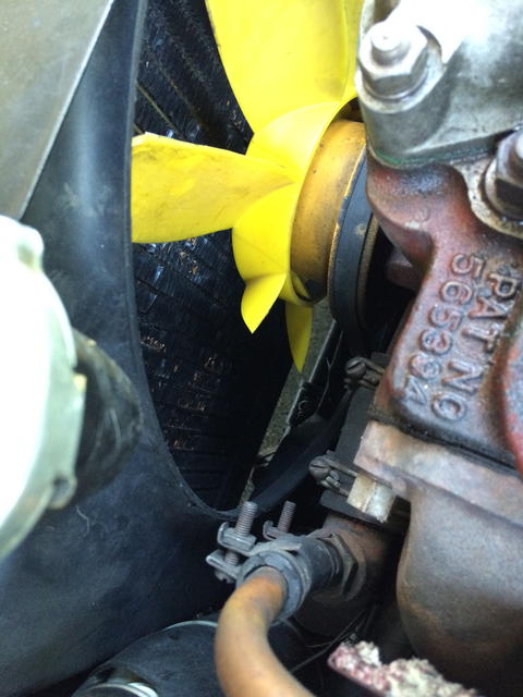

Oh Boy!
Did I speak to soooon about my plastic Fan!
Add this one to the list. one year to the day I ordered it! Of course it was about 1 week before I installed it on the car, so that puts it less than a year in service.
11,238 miles before it broke doing high speed on the interstate ( 70mph,maybe a little more cool smiley).
Fortunately no damage to the Rad, hood, hose etc. makes a hellava noise when it goes though.
I spoke with Moss this afternoon and they said send it back for credit. I ordered a metal one for replacement. In the mean time I'll reinstall the electric fan till the new metal one arrives.

We have been looking at the cooling fan that you sent back to us. The tips of all of the blades are damaged on the rear edge, which is really weird. You can kind of see the damage in the image you posted.
Are there any marks on the inside of the shroud indicating the tips were hitting?
I've seen cases where the blades flex forward under high speed and hit the upper or lower tank, but not a blade that is damaged on the rear side. I think Mike Vickers is in touch with you on this. Obviously it is a concern.
I initiated these plastic fans after bringing in my sample that I bought from the factory in 1984. The design and materials were to be exactly to the original specification. Over time, that may have strayed so we are doing a full analysis of the material to ensure it has not been cheapened.
Kelvin.
Moss Motors.

Yes , as stated in my initial post, the witness (contact) marks were a result of the blades coming into contact with the fan shroud.
"Full disclosure, when i installed the blade, the fan shroud was close enough to catch the tips of the blades and shave off 1/8 inch.
I didn't take the blade off of car to inspect it fully so it may contain fractures that i didn't see."
When this happened on start up i made corrections to the fan shroud by using Ty-wraps to pull the shroud away from the fan. The Ty-wraps remand in place until I removed them after the incident.
I would have loved not to have installed the shroud on my car, however the higher temps with the MGA's any additional help with cooling is a plus.
I'm not blaming the failure of the fan on design or manufacturing of the part.
Yes it did make contact with the fan shroud so this is a factor that needs to be considered during the evaluation.
The only reason I sent it back for evaluation is hopefully to determine of it was
1. Possible bad production run or
2. Operator install failure.
Dave
