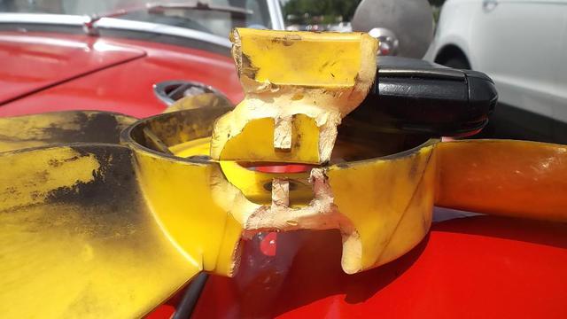

This may be a bit disturbing. I have now had multiple cases of replacement plastic fan blades that have broken. This is Moss Motors part number 434-332, replacement part for original 6-blade steel fan on 1962-1967 MGB. It is also sold as a "modern" replacement part for the MGA steel fan. It is "similar to" the OEM plastic fan for later model MGB (but may not be exactly the same structural configuration).
Date Miles
07/20/77 150,000 Purchased used MGA
09/25/95 220,000 Broken steel fan blade (220,000 miles) Install a used one.
05/06/15 445,038 Install plastic fan, Encinitas CA.
07/16/15 455,667 Plastic fan failed 2-blades, Weaverville CA. (10,630 mi)
08/15/15 458,719 Second new plastic fan installed, Hillsboro OR.
04/12/16 479,540 Repair radiator #1 damaged by plastic fan broken blade, Matoon IL. (20,821 mi)
05/13/16 482,369 Repair radiator #2 damaged by plastic fan broken blade, Raleigh NC. Install steel fan
One month to the day from the last broken blade and radiator repair. Exactly the same damage to the radiator, but at the top this time. The blade fracture is much different. Prior blade breaks (three of those) occurred at the thin base of the blade. This time the wide flange of the hub is breaking up. It appears to be stress cracks originating near the leading edge of the blade root. In the picture you can see one blade gone and another on opposite side about to let loose. I assess this as typical 1970's engineering trying to make everything as cheap as possible without regard to strength or quality. Pretty obvious (to me as an engineer) that the plastic is not thick enough to have sufficient strength to handle long term stress.
Now I want to know if anyone else has encountered failure of the same part number replacement plastic cooling fan. I have had them last 10K and 20K miles, but so far two or two have broken, and no keeper. Perhaps no one else has driven this many miles on one of these plastic fans. But if you have more than 10,000 miles on one and it has or has not broken, I would like to know about it.

Not yet but I was about to send a note to Moss. With the first blade failures (at root of the blades) I gave it the benefit of the doubt, thinking the blade tips may have contacted the metal fan shroud. in years past I have had a metal fan contact the steel shroud with failure of an engine mount. That chewed up the shroud some, but no significant damage to the steel fan (which I continued to use for many years on).
Since the second blade failure I have removed the fan shroud. But this latest breakage involves failure of the hub, and two blades on opposite sides of the hub. I was wondering about the material, if perhaps OEM parts for MGB may have been made with Fiber Reinforced Plastic (generally good for structural parts). These replacement parts seem to be plain plastic, no reinforcing fiber that I can see.

I purchased and installed a moss plastic fan in July of 2015. I have just a tick under 10,000 miles(9,953 miles) on it since.
I took a quick look at it this evening. One blade i observed has on it what appears to be what looks like a scratch? The scratch is deep enough to catch the tip of my finger nail on it but the other side of the blade is clean.
Full disclosure, when i installed the blade, the fan shroud was close enough to catch the tips of the blades and shave off 1/8 inch.
I didn't take the blade off of car to inspect it fully so it may contain fractures that i didn't see.

My radiator has been fixed (again), and a (used) early MGB steel fan installed (like I ran for a decade before). I will send what is left of the latest broken plastic fan back to Moss. It really is a bit of a mess. Fortunate that we found the broken off blade for forensics. Another blade is "caught in the act" about to part company in similar manner. Light yellow parts of the fracture appear to be long term creeping stress cracks, while the more ragged whiter parts appear to be more instant fracture at time of final break.
As far as I can tell, there is no sign of any reinforcing fiber in the plastic. A club friend here in Raleigh was just chatting about an original MGB plastic fan on his car that was rubbing on a bolt after air conditioner installation. That blade did not fracture, and he claims it is still in use, but he did say it had clear signs of reinforcing fibers sticking out at the abraded spot.
