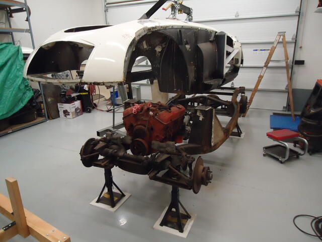

Hello everyone,
I am looking to build a body rollover jig for my 59 A. I know I've seen a few on the Forum but my search only shows mainly MGB's.
I am concerned about getting the balance point correct so it rolls easily.
Also what points should I bolt to? I have the door area braced well along with cross braces across the cockpit.
See picture.
Thanks
David

A friend (and MGA club member) used two ending stands and some tubing and angle iron to make a rotisserie for an MGA roadster. I adapted it for my MGA coupe, but it was easily changed from one to the other and a friend used it for his Healey 100-4 as well. Attached are some pictures. so, you can get the gist of it. The long tubes are like large conduit and can be pieced together with adapters to attache to the goal post area mounting, rear cockpit mounts and rear trunk area mounts to support the body. The roadster is a bit easier as the bars pass through the spare tire hole and over the trunk lip, but it worked fine on the Coupe as well with mods.

That gives me a good idea of where the balance point is for rolling the body
