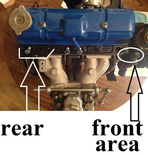

It should look like this and is located on head studs at the rear of the motor. The front is slightly different.

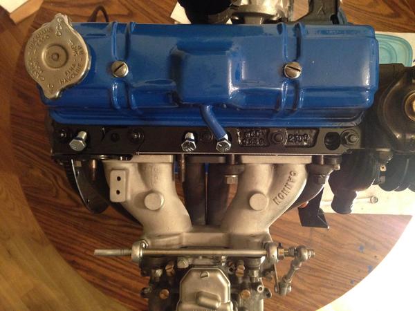

It's difficult to pick out because it's black like the head, but it spans the left most silver bolt in the picture. This is the rear one. The front one does indeed mount between the water outlet housing and the generator. I usually don't have the generator mounted when I install the engine so I use the lower generator mount bolt as a lift point.

Two per engine, correct.

The battery charging device is an alternator in most cases not a generator. The front is difficult to make out but I think I have "ball parked" where it belongs. It also is slightly different and I believe of thinner gauge material.

Nice catch Rick. Did I nail the location for the front lift?
