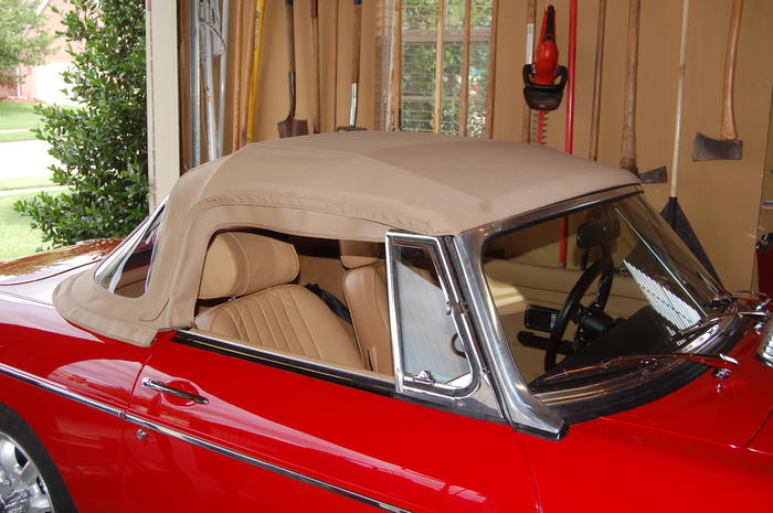

As always, that started with reading up on top installation, checking out the MGBE library, the Porter book, and searching for forum threads. Additionally, top installation is covered in the second half of episode 8 of "An MG Is Born" - I watched that a few times.
Step 1 of the installation - install the hardware on the body. There were a couple of tricks to this. First, on the passenger side, I had welded in a patch panel where the front clip is attached, so I had to locate exactly where it needed to go and install the clip. On the passenger side, the clip rivet holes had been filled over, so they had to be redrilled, hopefully in the same location.
To make that job easier, my buddy Bill had a shell available with all the hardware removed, so I made some templates, one for each side, using manila folders. Using the fender beading as one datum and the stud holes (which my car still had) as the other, I was able to precisely locate the clip holes. I taped over the paint to avoid the drill chipping it, put down the template located by the datums, located the clip on top of the template, and drilled through it. Perfect, it looked like I went right back through the filled holes on the driver's side, and the passenger side location worked perfectly with my new top.
Then to install the studs. A couple of things here. First, I wanted to use gaskets under them to get a good seal and minimize the likelihood of distorting the sheet metal. So I cut some out of gasket material using the studs as a template, inserted into a wooden block. Worked great. The second aspect was how best to get the hardware - washer/lock washer/nut on the stud, knowing that if I dropped them, especially the fwd 2 that are above the dogleg, I might never get them back. And in the other 2 locations you actually have less finger room, so I needed some way to safely manipulate that hardware.
My solution was to tape the nuts and washers to a wrench, then feed the wrench in to the hole, line it up by sight, then insert the stud. Worked great.
I collected the various parts from around the house, and staged them in the garage, in the process rediscovering the fact that my header rail had a small but noticeable dent in it, pretty much right in the middle. It would definitely show through the top. Still wondering how that might have gotten there, but it was there when I got the car. So this would be the last filler job on the car - I pulled out my angle grinder with a 40 grit rolo disc on it, roughed up the surface, mixed up some Duraglass, applied it to the rail, sanded it down, and drank a toast to being able to put away all my body tools for the forseeable future. Woo hoo!
The basic procedure used was:
1 - fit the frame to the car, including the header seal (without the retainer, just clamp it between the header and the windscreen top rail).
2 - fit the top over the frame, starting at the back - the rear bar, then the door tab clips, then the lift-a-dots
3 - pull the top over the header rail. This is a 2 person job, one at each corner. Put down 3 strips of masking tape vertically - one in the middle of the windshield, one at both ends, to allow us to mark where the top needs to be laterally, and how far it needs to be pulled over the frame toward the front of the car to be taut. We used a magic marker to make a vertical mark at the edge of the top extending down onto the tape.
4 - We ran a chalk line where the top lapped over the front edge of the header rail.
5 - Fold the top back, onto some plastic sheeting so that any glue doesn't get on the top. Transfer the chalk line to the underside of the top. Apply contact cement to the bottom of the top from the chalk line back a couple of inches
6 - Apply contact cement to the top of the header rail
7 - When the cement is dry to the touch, reapply the top to the header rail, using the marks on the masking tape to get it positioned to the original place you had it, if not tauter. Press down firmly so the top is well adhered to the rail.
8 - Open the top up, fold it back. Apply glue to the front edge of the top, and the underside of the header rail (i.e., where the seal goes). When dry, wrap the top over the front edge of the rail, so that it's glued onto the sealing surface.
9 - Install the seal retainer. I used screws, which made it "easy" for me to redo this process when I didn't have the seal in the first time and so didn't get a "taut top".
10 - Install the seal into the retainer. I used the same "hook tool" that I used to install the windscreen to body seal.
That's the procedure. Of course, there was some trial and error in determining it. The major issue, as mentioned in step 9, was that in my first attempt, I didn't have the seal between the top windscreen rail and the header, just the header clamped directly to the top windscreen rail. We went through the entire install, but when I had the seal in, and the seal retainer, it basically pushes the header rail off of the top of the windscreen, shortening the top frame, and allowing the top to sag. Not good.
So after a break (boy, it was HUMID), I undid everything, and did the 'clamp the seal in between the rails' thing in my step 1 above. Something I hadn't read about, or at least noted, in the "how tos" I'd read for this, or seen in the "An MG Is Born" videos. But boy, it made all the difference.
I went back and rewatched the "An MG Is Born" episode - when they did the top, they showed them putting the top up, nice and taut, but before they had installed the header seal. I'm betting they ran into the same problem I did, once they put their seal on, and just didn't bother going back and explaining that. Arg.
Anyway, the top is on, nice and taut. The first time I pulled the clamps down, it was a bit of a struggle, but got much easier after leaving it up for a day.
I've seen posts where this task is done in small steps, gluing a bit at a time. Or using a lot of clothes pins to clamp the cover on. While I tend to try to follow a well trod path, this just seemed unnecessary to me. So I went at it in one big, quick, shot.
