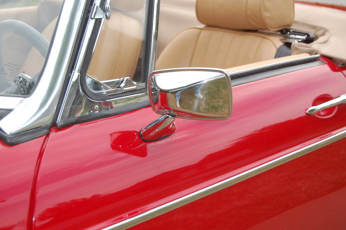

When I disassembled the car, the door mirrors were in such a sorry state I just tossed them. Probably a mistake. My advice at this point - keep everything, even if you think it's junk.
So in one of my part buying binges, I looked up the style of the door mirrors for a '72, and ordered 2, one right, one left.
One of the last things I did before hitting the road for French Lick was to install the driver's side door mirror. I had foggy memories of reading posts about problems with the current model of the '72 mirror style - and those memories became clear when I tried using it. It could not be oriented to give a clear view of the area you're supposed to view with a door mirror. Yeah, if you moved your head into an awkward position, you could see where you needed to, but basically, it was useless. It just could not be adjusted to scan "out" far enough.
So I didn't bother installing the passenger side mirror, and drove last year without a functioning door mirror. It looked ok, and if a door mirror is required by law (and I have no idea if it is or not), I had one. The lack of usefulness generally wasn't a problem, since I tend to swivel my head for a clear look when merging left anyway. But still, a mirror would be nice...
The options seemed to be: find an original, or NOS mirror. Or try the mirror that was used from '74 on.
I went with the latter approach. I ordered a repro mirror from VB (the original "Tex" mirrors are available from Moss at about twice the price). Since my first mirrors were pricy "Tex" (the original manufacturer), I didn't put a lot of stock in the brand name, and went with the cheaper approach.
This weekend I switched over. The door hole spacing is supposedly the same (1 1/2"
, but the new mirror base holes were actually a tad closer than the original mirrors, so I had to carefully rat-tail file the holes before I could get the new base installed.
But once on - wow, they work. It's very nice to have a door mirror again. Now - should I do the right side or not?
