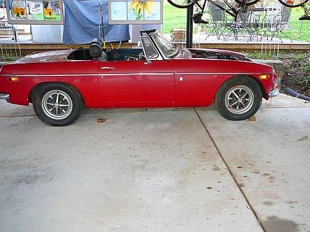

I posted in the forum awhile back that I got back into the MG game with car # 265842. Here's what's happened since.
Car was in Nashville, I'm in Tulsa. Flew to Nashville last weekend, rented a Uhaul and tow dolly. Loaded the car up, the PO had the drive shaft already detached. Loaded a bunch of parts into the truck, including:
- LH outer sill
- RH rear fender patch panel
- new bumpers
- 5 wire wheels, primed
- new grille
- new hood
- windshield
- couple of top frames (looks like both the older types, one ubuild it and one finger-pincher)
- various mechanical parts, seals, harnesses, etc..
We put on the new hood, put a tarp over the cockpit (no top was fitted and I didn't want to mess with it) and I took off.
Drive from Nashville-Tulsa took me about 13 hours to go 640 miles. Included getting stuck in the mud in West Memphis, AR. (understimated the turninig circle of the beast). Lots of stops to check on things, retie the tarp down, etc.. Concluded at the end that whatever truck drivers earn, it's not enough.
Got eaten up by gas costs - I think I got about 6-7 mpg for the trip.
Since getting her back I've begun the disassembly process. The interior got ripped out, nothing to save there except the seat frames. I got the dash off last night - only had to fool with 3 of the attachment nuts, the others were already gone. If you ever need to get the dash off a '72, bring a 3/8" socket, universal joint, and 15 inches of extensions to the party - that's what it took to get to the toughest nut to access, just to the right of the steering column.
This weekend the plan is to get the fenders off. One of them has a dent in the top, and peeling paint over a previous dent fill job. I'm 3 classes into a autobody repair class at the local votech school, and I'll get the instructor to work with me on trying to save the fender. He knows what I'm trying to do, so I also feel confident that he'll tell me to go get a new one if this one's too far gone. We'll see.
Lots of other rust to deal with. The boot lid has rust bubbles on the exterior rim, it looks like water got trapped in the seal lip, and ate away. Not sure if that's salvageable.
The inner sills look and feel good. The castle rails seem ok. Jack mounts are solid. I expect both outer sills and vertical panels will need replacement, there's rust bubbles on the RH outer, will know more this weekend. There are rust bubbles over the LH rear fender wheel arch, so the patch panel will come in handy and I'll probably need an inner patch as well. RH looks ok, but I'll know more after stripping the paint. Heel panels and spring mounts look good. Underbody generally looks good.
The PO was proud of the "professionally installed floor panels" - well, maybe someone charged money to install them, but that was the only thing professional about the job. I've done about 15 minutes of MIG welding so far in my class, and I'm pretty sure (ok, I'm positive) that I could have done a better job on those panels. I'll be taking them out and starting over.
I plan to use chemical stripper. The car is currently red, but was originally BRG, then a nice dark blue.
The RH door gaps seem a bit tight, not sure if that's due to all the paint coats, or if there's some sagging going on. I'll post some pictures over the weekend.
The LH door was already de-hinged. Where does one find a posi-drive bit to fit?
I've got a big order of air tools from HF on the way. Already have a PC air compressor - 25 gal tank, about 6 cfm at 90.
Mechanically things look ok. No leaks or seepage from the engine, tranny or diff. The car shows 56k on the clock, but the speedo cable was disconnected. The PO claims the engine was 'rebuilt' about 10k ago, which could be true. The engine cranked well, but I didn't try to start it. I'll give it a once over once I get it out of the car, maybe plastigage one of the bearings, and go from there.
Anyway, the project has begun. People ask me 'how long', and I tell them 5 years. Maybe I can beat that.
One thing for sure, other than the body and the mechanical lumps, everything else needs replacement - anything that was vinyl or plastic or rubber is gone. I'm going to have some massive parts order to somebody.
