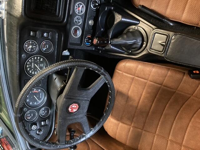

I put this into my late model B several months ago and I am very pleased. It is a joy to drive.
Ordering: I purchased from Frontline. They were easy to deal with (except for time zone challenge). Delivery and packing were no problem at all.
In use: Lighter and more reliable than the OD gearbox. Quick and smooth shifting. MUCH more useable 2nd gear. No more accidentally hitting reverse during a 3-2 downshift! Far easier to bleed the clutch.
Installation: as per instructions. The only challenging part was trying to push the tail up over the crossmember. It is a tight fit! I shed no tears for the permanent removal of the removable crossmember!
They didn’t send me an MX-5 clutch alignment tool. I had to borrow one from a friend.
Feedback for Vitesse: the shifter was way too tall. In 2nd gear, it interfered with my hands on the steering wheel. I had to shorten and rethread it down several inches.
I was not a fan of the supplied, round, “8 ball” shifter knob. I don’t think that suited the car at all. I had Mike make me a new one. It looks beautiful!
