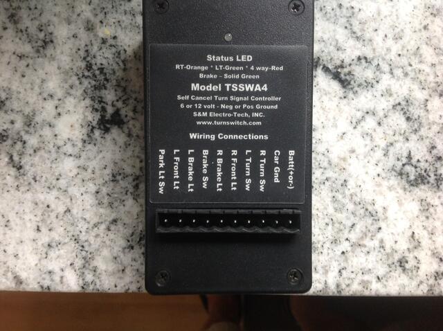

Since then I found a company Electro-Tech thru a ad in a car magazine. They made a system that was a small box that allowed you to integrate all the wiring of a modern car along with the turn signal switch into legacy cars. Really a super guy to deal with. See picture below.
Thanks for the input.
