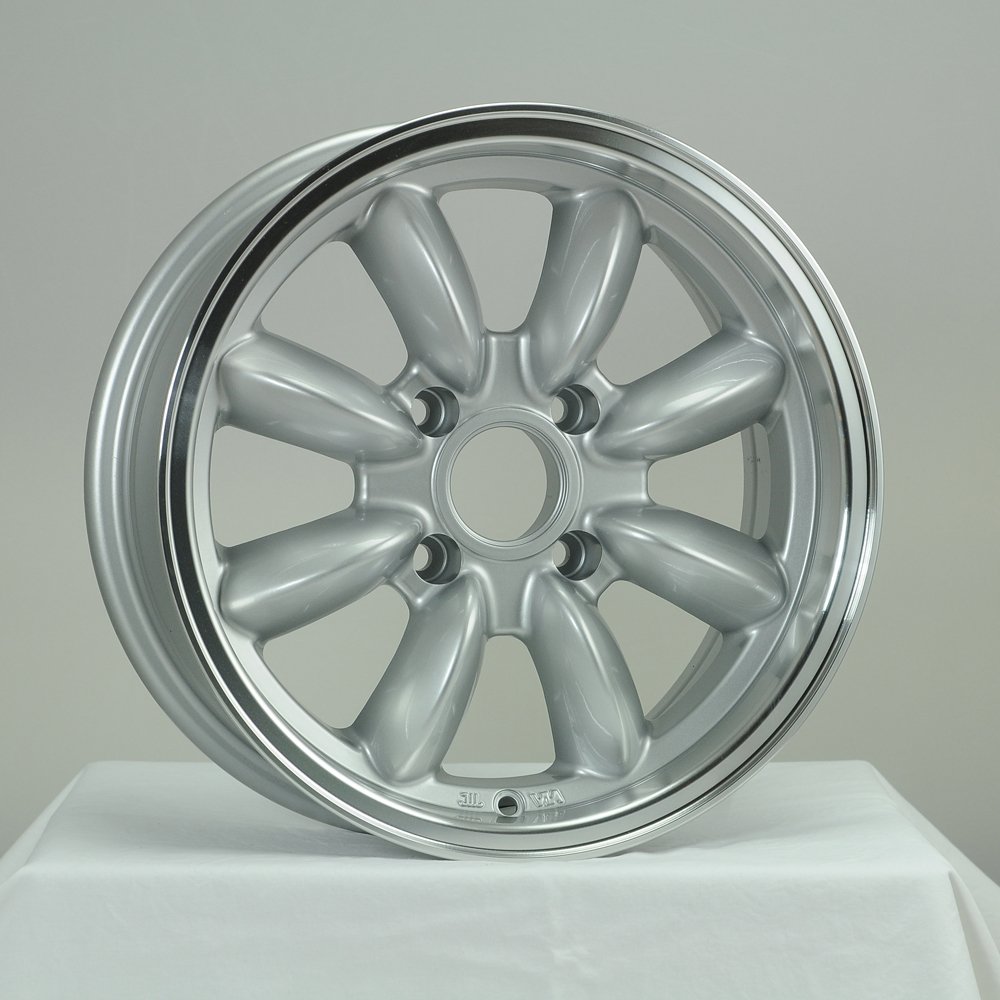

Has anyone put on Rota OS Mesh wheels (15X7 4X113.3 +20 RS) on their MGB? The EBay seller claims they fit. I am not sure. And if anyone has them on their car please post a pic and size of tire. I'd like to know what they look like on the MGB and what size tires fit?
Looking for bolt on spoke-like wheels (without spoke hassle).

They can be made to work. They will protrude outward 29mm more than your OEM RB Rostyle wheels, but 4mm less than what I am running. With hard cornering, I had to turn up the fender lips & install a panhard rod (rearend moves quite a bit).
So, they can work. If you want bolt on & go with no worries you need some more positive offset

Yeah, the offset isn't right.
I put these on my '80 MGB
4 PCS ROTA RB WHEELS 15x6 PCD:4X114.3 OFFSET:25 HB:73 SILVER WITH POLISH LIP WITH BIG CAPS

X2 Clark.... ROTA RB 15 x 6 w/ Dunlop Durezza Tires.

I have the same wheels purchased from Ebay (Wheelstop). Fit and look nice. Priced reasonably.
Your tires are much bigger though.
