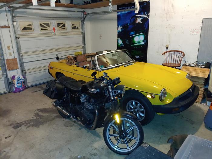

Have a 1974.5 MGB Roadster wanting to make modern day reliable driver. A new company has been making MG'S that can run 0-60 in under 4 seconds with power steering ac and modern day comfort. Wanting to know what kind of engine swap I can do that will leave me enough room to put in ac and powet steering too. I'm looking for reliable. I believe they call it an MGB LE50 but it's like $80,000
