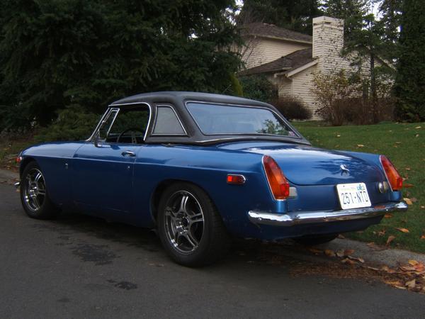

Nice v6 and at times v8 BOPR conversions come up for $10-15k at times
Keep an eye out..

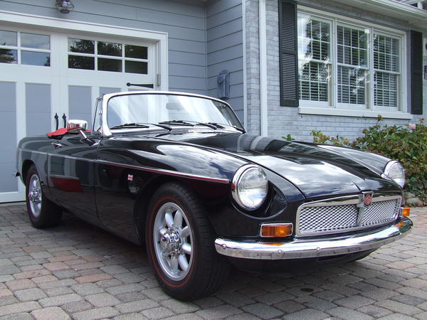

For sale
Nicely done 3.4 injected T5
Well sorted
Excellent
$14k
You couldn't build one this nice for the asking price.

Just caught this thread, thanks Rob!
I will say the redlines have been recently replaced with 4 new Michelins in all black.
New steering rack went in in Sept.
