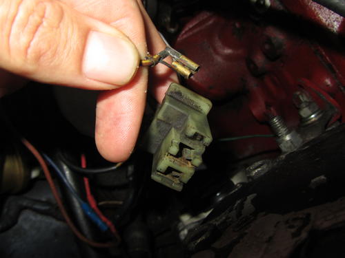

How does this plastic alternator plug work?
Posted by Novio
Mar 29, 2011 07:00 PM
101 Posts
Hi all - When taking my alternator off the car, a wire came loose. I've been trying to get the wire back in the plastic connector but I'm not sure how to get it in there so it stays. Is there a trick to this thing? Can't seem to figure it out.....

If you look carefully, on most of these type of connectors there is a tiny little "ear" on the flat side of the metal connector. It is meant to point slightly outward. When you push it into the plastic housing, it compresses as it goes past a ridge and then clicks outward so that it can't reverse its way out. Either your ear is bent (bend it outward slightly), missing or the plastic is worn so that it no longer engages the ear.
As long as you hold it in place when you engage the connector, and make sure it is firmly seated, I don't suppose it matters a lot whether it clicks in place.

There should be a tab on the back side of the terminal it should be just above your center finger. You probably need to bend it out so it will catch on a notch inside the plastic plug haousing. That is, if it hasn't broken off. In that case you will need a new terminal.

Probably don't need to replace the terminal.
First, test fit the bare terminal over the male blade in the back of the alternator. Remember to test on the smaller blade.
If it is a snug fit you are good to go. Just stick it in the back of the plastic plug and when the plug is firmly home use a small screw driver to push the terminal in to make sure that it is seated well.
If the test shows that the terminal is a little loose on the blade, carefully squeeze the two rolled edges just a tiny tad so that it clamps better on the blade.

Thanks, gents.
Jack - I believe it fits pretty snug on the bare metal so I'll probably just stick the terminal back as you suggested.
