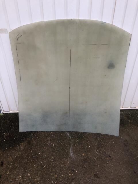

I have today finished making my headliner board, this is Mark Burton’s idea but it is incredibly simple. My GT is still in primer but I wouldn’t have any qualms in making this headliner on the roof of a show car. The PVA release agent is water soluble and washes off without leaving a trace. The cost was less than £100 but I have enough material to make two more left over. Exactly as Mark Burton described and Using poly sheet and masking tape to protect the paint it took just four hours from start to finish to make it. Trimming it to shape today took about an hour and a half, if you have the old headliner cover then you have a template and it would only take a few minutes. I didn’t use gel coat simply because I will cover it with closed cell foam then the headliner material.
I would recommend this method to anyone.

@#14: Philip to save me going back through Mark's exhaustive topic that's the version he did by laying over the top of the roof and is therefore curved and locates to the body rather than the flat board? Do you have anything between it and the roof's underside? Are you sticking it to the roof or just relying on the cants and header rails to hold it in place and,if so, how thick is it? What PVA release agent did you use so I can try and find in AU?
