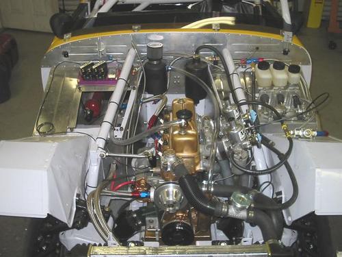

I got both a HF air nibbler and a set of thier air shears. I finally had a set of thier shear lay down on me after three race car builds and about three years of heavy use, so I decided I would buy a better quality one, I got Mac off the tool truck, took it out of the case and relaized in about minute, it was half as god as ther HF one and four times more expensive. The HF nibbler and air shears are as good if not better than most brands you can buy.
Air nibbler: A nibbler is a good deivece to have if you need to make some compound curve and such, it kind of leaves a tooth mark looking finish, so cut outside the line because it isn't finishing tool, I use this tool way less than my air shear, but it pays to have it around for that every once and awhile job.
Air shears: now here's a tool I can't live without, it will cut thinner aluminum and steel section for sheets alot easier than anything else. BUy the HF unit is as good if not better than most higher prices unit, and you're talking to someone who has been thru about a dozen of them.
Cut-off wheels: They still serve a purpose and are part of my arsenal of sheetmetal working tool, but you don't want this to be your only method, as they can be expensive and consume themselve rather quickly. Tip: the cutoff disc that HF sells are just as good as the Norton ans other brand name unit at a fraction of the price, I also get those flapwheel disc form them as well, these bad boy can cost $6+ a piece in a tool store, but at HF they are like $5 for a pack of 4 or 5, and just as good as the higher priced ones.
Hand files and patience: This is what separates the men from the boys when it comes to quailty sheetmetal work. While all the above mentioned tools work great to get you roughed out, when it comes to final fit and finish, there is no magic wand special tool to get that almost perfect fit, it just hand files and patience, belt sanders on the thin stuff can grab the piece and bend the crap out of it, so I dodge the belt sander on most sheetmetal work. Hand files, here where it pays to buy the good stuff, there is definate quality differences in hand files, get some good ones, all different shape and bastard files and smooth files as well, make sure you have rat tails and half rounds in your arsenal of files.
Hand snips: The color handle set Craftman sells at Sear is about as good as it gets, then I also have one big hand shear for longer cuts and thicker stuff.
I pride myself on custom sheetmetal work, I'm sure I could get a job right now in Nascar doing this if I wanted to do this for a living. The best advice I could give you, is make really good templates to go off of and be patient, it's the kind of work for a nice piece that you have dedicate some time to, and it very self rewarding when you make a nice fitting piece.
I made everything you see in these pictures with the above mentioned tools and alot of patience.
