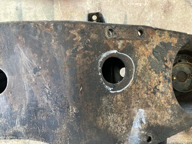

This is a simple cross member mod to do while the cross member is out. This will save many 4 letter words during the install process.

bottom hole to be modified.jpeg    69 KB
straight shot.jpeg    63.2 KB
