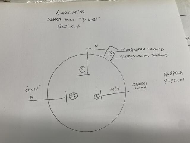

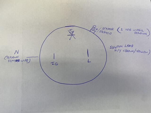

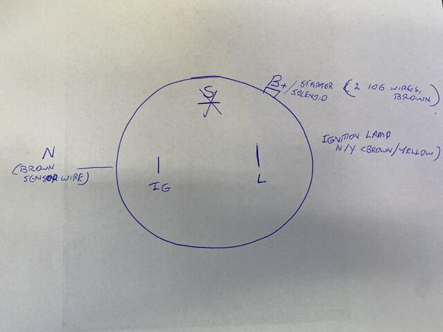

I am stumped on making the proper connections to a Denso(clone, via E-Bay) Mini Alternator. In the past I converted the car (‘71 B-GT) from a Lucas 5-wire alternator to a Bosch 3-wire. I due to hood clearance issues with the alternator being mounted on top of the A/C compressor is the reason I am going with the Denso alternator as it is physically 2/3’s the size of the previous Bosch alternator, but still rated a 55Amps output, and clears the hood when shut.
So far, the only connections that provide good power output (13.7VDC at idle RPM) and power the “Ignition (alternator) Lamp” are in the photos attached. However, with the engine running (idle and higher RPM’s), the Ignition Light stays, illuminated, despite the alternator is showing 13.7 VDC output. I found on Denso’s website that the alternator needs to reach 1200RPM to initially produce current, then will continue to produce current at lower RPM’s.
My quandary is why is the Ignition Lamp still illuminated while the alternator appears to be producing current? Is this a wiring issue or possibly a defective alternator?

The alternator was advertised as a “3-wire”, but FWIW, its producing a charge (13.4-13.7 DCV) with just the brown “sensor” wire connected to the to the “IG” port on the alternator. In fact I drove the car about 10 miles today with the Alternator (Ignition) Light wire disconnected.
Looking forward to which diode you have installed and photos of how you wired it.

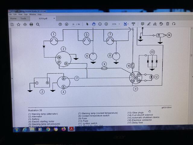

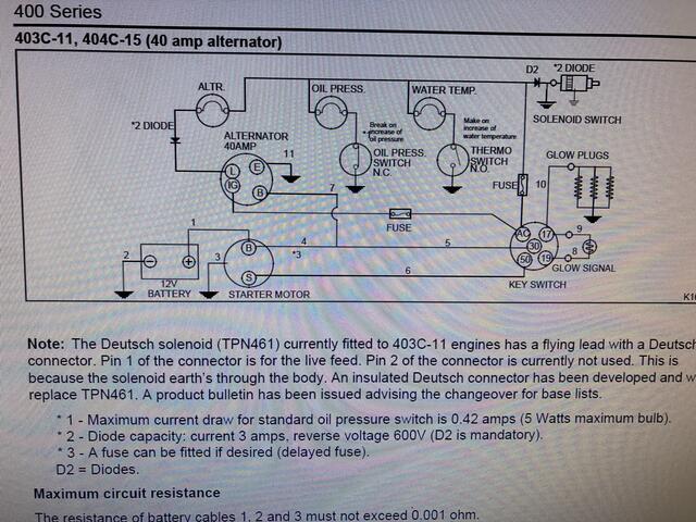

I found a couple of wiring diags for your alternator that you can try.
On yours I'm thinking that the brown is hot all of the time. Perhaps these images will help. My brown wires are attached to the BAT terminal.

It appears we are both using the “IG” and the “L” connections. I currently have the original “Sense” (brown) wire from the original Lucas alternator installation (used again as “sense” on he Bosch alternator) hooked to the IG port on the Denso alternator. That wire is “hot” with the ignition on. The only connection so far that will cause the Ignition Lamp to illuminate is its Brown/Yellow (N/Y) original lead to be connected to the “L” port on the Denso.
