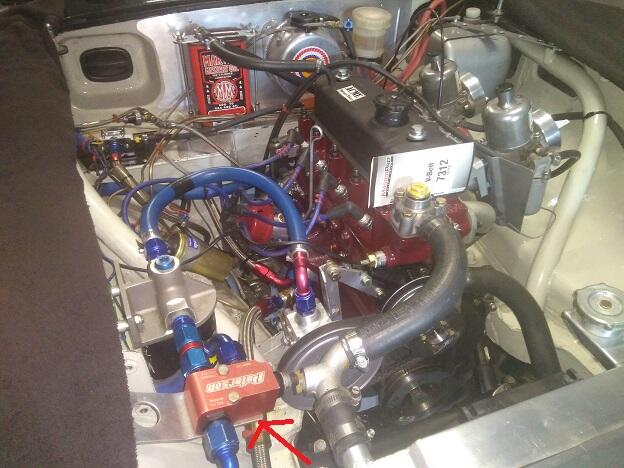

Remote oil filter is a nice touch on a car with cross flow we do the same thing on race, and most of use put the along right side fender rail. One thing it allows you to do is use oil oli filter housing that allows you to use a better filter, most folks go the ford route, and I use a high end Wix racing oil filters. There's a lot more going here than just a remote oil filter, but you can see how I mounted mine. Another option would be to get one of the aftermarket hanging oil filter housing made for the earlier MGBs to replace the cartridge housing with, but the remote housing is a lot easier to deal with.
