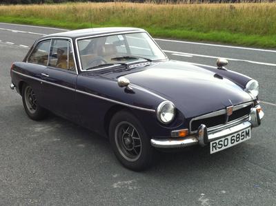

When I got Sammy all her tyres had inner tubes. When I got new tyres fitted all round, the tyre shop just went and dumped all the inner tubes - and surprise surprise, got a rim leak they couldn't fix on a couple of the rims. For some reason I can't remember, but I'm sure it can't have been very good, they didn't seem to think that sticking the inner tubes back on again was a reasonable solution - maybe they'd trashed them when they took them off.
I went to the only place around here likely to have any old Rostyle rims lying around (20th Century Classics) and got the only two rims they had that weren't absolute eyesores (even in my uncritical eyes), and we finally achieved 5 wheels with tyres that would hold air.
Except one of them is now losing air again - I assume it's another rim leak (although to be fair I haven't actually checked yet, but I've done very few miles, so it seems likely).
Anyone successfully dealt with a rim leak using those spray-stuff-in-the-valve type kits that seem to be replacing spare wheels in so many modern cars? Or do they just tend to coat the tread region?
Any other bright ideas? Otherwise I guess I'm either buying a replacement rim from somewhere it will have to be posted (expensive), or trying to find someone in Aberdeen who'll sell me an inner tube.
Thanks, Richard & Sammy ('73 Black Tulip BGT)
