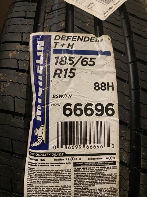

Just went through this when I found my old 15 wheels were severely rusted inside from water getting around the valve stem. MGA might look better with older style width and tread but on my B I chose 185's see picture. I posted a lot and the consensus was to get new painted 5.5 wheels. My old 15's were acually only 4.5. This was a recent post. Have fun and ggod luck. I went with a more modern tread design and rubber compound. JIm
