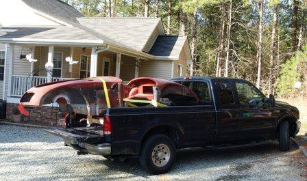

Wow, thanks everyone for great advice and info. It all became clear when Eric said "you'll be removing and installing those wings innumerable times!" Hmm, where's the smiley with my hand slapping my forehead? Maybe also need a smiley to say "oh, man, this is going to be even more work than I thought!"
Great tips, guys. Thanks. Here's some pictures of my car.
