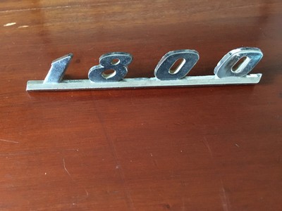

My '56 MGA 1500 came to me (in 2014) with a Nash Metro engine substituted for the original engine. Since it was running OK with no over-heating and no ominous noises, I just left it in there and enjoyed the car for the first few years, while I sorted brakes, suspension and electrical systems. Someone had installed twin SUs, so that helped, I guess. But, even with the stump-puller rear end that was in there (nom it wasn't the stock 4.3 dif.....it was MUCH lower than that!), performance was only pretty mild.
So, after finding and purchasing three 18G engine cores, I rebuilt one and installed it in the MGA. Not quite a straight bolt-in operation, but pretty close to one. With a strong (but stock) 18G installed it just ripped through the gears. I mean, it got through third and fourth just as quickly as it did second. But, I wanted to do some long distance touring with it, so I switched to a 3.9. Not as quick off the line, of course, but great for touring.
I retired the H4s in favor of a pair of HS4s from my parts stash and a buddy of mine rebuilt a 25D distributor for me. So, the engine runs real sweetly and pulls like a train. So, I'm quite pleased with it.

You could also use an emblem from an Austin 1800 from the 60s.

Hi Got this from somewhere But cant remember where.Have been told it is a nash Metropolatin Has the casting for a tachdrive but covered over with blanking plate.Also thinkit has a fuel pump casting too also covered over.Terry
