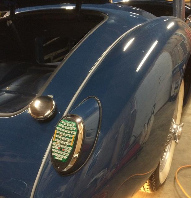

Folks, searching for an upgrade to the read lights on my MGA that would allow the existing 1500 setup to be retained without having to add additional indicator units to the bumpers or bodywork externally. I came across this LED kit:
http://www.bettercarlighting.co.uk/index.php?act=viewProd&productId=638
The company sent me some pics, which look promising - see attached.
Barney's site has very useful info on this subject, but I don't think these have been covered (yet).
Does anyone have experience of this kit?

I have a set of LED lights for my 56 MGA, although not quite like these as they don't have the Orange indicator included
they are really bright. They came as a complete unit ( remove the old bulb unit and fit the new all in one base-LED light-unit)

I bought mine from BMC Autos, Brian McCollough. http://bmcautos.com/britmarket/led-taillights/mg/mga-1500-1600-more-led-tail-lamp-set-l549-pos-earth-detail
Picture 4 is just the running lights as I did not have the brake light wires hooked up to the switch when I took these pictures.

I have the same kit from Better Lighting but not installed in my 1500 yet. The indicators require a thin twin wire to be added, and run to an electronic flasher unit. Unfortunately, the one that BL supplied to me only has 2 terminals, so no take off for the indicator light on the dash.
I am pondering that at the moment, and think the solution will be a three terminal electronic flasher.
Let us know how you get on. The BL arrangement looks more stock than the multi LED set up you see above. Also, I have seen a problem with "brake light switch bounce" on these multi LEDs.

I can vouch for Brian's system, I have had them for years.
He was great at customer service too, after his shipping guy sent the first set to Swaziland instead of Switzerland (next to each other in the drop-down menu....). I had a question a couple of weeks ago, and he answered it very fast, and even remembered me because of the shipping screw up. The only disadvantage is that the bayonet fitting has to be removed from the base.
An alternative now is a standard 1156 or BA15D red LED bulb - these were not available at the time i fitted Brian's solution, but can be found for a few $$ each too
http://www.ebay.co.uk/itm/1156-BA15D-21-SMD-5050-CANBUS-OBC-No-Error-Car-LED-Light-Red-White-Yellow-ZC-/131995724998?epid=936600788&hash=item1ebb8eecc6:g:bHoAAOSwnbZYIDat
Although I fit these to many cars because they are much cheaper than the BL one, most agree immediately that the BL solution is much brighter.
For the front on my 1500 I use a so-called switch-back LED that has a white sidelight, but flashes amber for the indicator. about 2USD each on eBay including shipping. Buy 4 and have some spares or to give away

Is this the Classic Auto system the same as the system offered by Moss? The one I was referring to at the start from BCL has red LEDs for the light/brake and an orange LED array for indicating, within the same light housing.
I'm really interested in this setup as I don't want to add additional indicators to the bodywork or bumpers. Hope to get one shortly, before the nights close in here.

There is no unit available anywhere that can produce an amber turn signal through a red plastic lens - the laws of physics forbid this.
The Moss units and the BCL ones appear to be the same, BCL is normally cheaper.
I forgot to mention you will also need an LED-compatible flasher unit - I use these as they work reliably and many others have given up the ghost pretty fast or not worked out of the box:
http://www.ebay.co.uk/itm/12v-3-Pin-10W-LED-Flasher-Unit-With-Diagnostic-Function-Merit-Malta-/131415257333?epid=1148748783&hash=item1e98f5b0f5:g:kOMAAOSwrnNXPwrl
