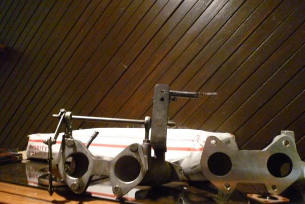

I am running with a Weber 45 and I want to install a TWM intake manifold; but the the inlet ports are 40mm instead of 45mm. I suppose I need to port match the manifold with the carburetor; but will it work properlly? or I'd better get another manifold?
I'm attaching a pair of pictures comparing the TWM, at the right, with a short manifold I used some time ago, so you can see the different inlet port sizes.

In short yes its very important the carb, intake and port are all matched. You could either port your manifold out but to be honest (this maybe just the pic) your TWM manifold still looks a little short and swan necked to be ideal. If you can get hold of a 45 long oselli manifold that may be better. They have a nice relatively straight "shot at port" design.

Tom, I think that is the long TWM, no longer available IIRC, and it's about the same length as the Oselli. IMO, the long TWM and the Oselli have similar performance capability. Both the TWM and Oselli need port work to be at their best as the runners are as-cast.

Tom,in the picture, the TWM looks shorter than it actually is; maybe because it has some elevation change; but in fact, the carburetor and small air horns barelly would fit in the car with that TWM.

So, I will be ok if I port match the TWM with the weber and making internal porting to the manifold. Thanks.

Yes, And while your at it. machine the head side flange at a 5* angle to tip the carb up a little for more fender clearance.

The shorter manifold you see at the left in the picture is about 100 mm long; the TWM is 150 mm.

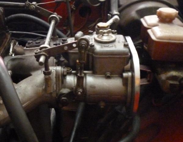

My engine bay is not as clean as I would desire; but the new manifold is port matched with the carburetor and the linkage is ready. As you can see, I still have the stock brake pump, so I barely have a Little gap for small air horns. In the future I will install another brake system and I will have the space for an air box.

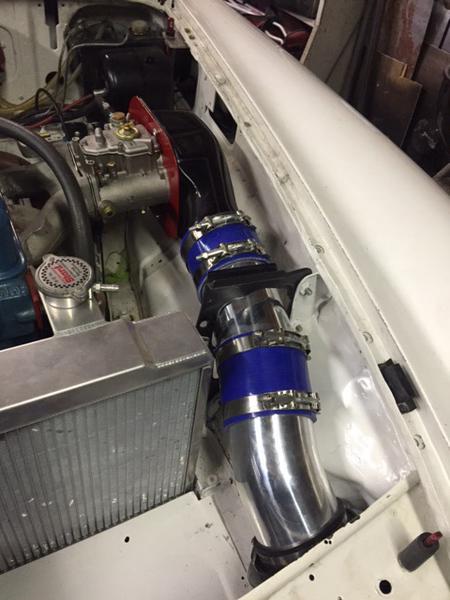

I have the stock brake servo and Feb-Tek long TWM, and was able to install a cold air box per the attached, shown with plenum cap and rad wall removed.
Edited 2 time(s). Last edit at 2015-03-16 09:00 AM by dcharnet.
image.jpg    39.9 KB
