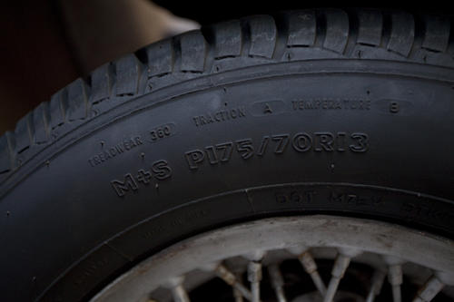

OK. I've asked before about tubes... but now for a possibly really dumb question... can, or should, I put tubes in a tire that is marked "tubeless"?
I'm really ignorant about tires. Went to Discount, ended up with tubeless tires, with tubes inside. Every now and then the go flat. TECHNICALLY, they ARE working right now... but I've had issues with the tubes being put in incorrectly. The tires are essentially brand new... so I'd rather not have to buy new ones, but its not a good idea to use them, let me know.
Secondly, and possibly more important... the tires are P175/70R13. I couldn't find tubes on the moss page that fit that size. How much trouble am I in?

You have a couple of questions. Tire stores can get tubes in sizes other than what Moss shows. A good tire store will know what to get. Make sure that you have the rubber bands in place or other protection for the spoke heads. Make sure that the wheels and tires don't have burs or rough spots. Use talc or powder like there is no tomorrow. A good shop should be able to set you up without any problems at all.

The issue is tubeless tires will fit both tubeless and tube style wheels. You have the later wheels so tubes are needed. Some wire wheels by Dayton are truly tubeless.
Use of talc, CAREFUL installation, wrapping the spokes with proper tape....NOT Duct or electrical....the tape and adhesives fall apart. These are keys to keeping tubes inflated.

The problem isnt your tires, the wire wheels are leaking air.
Before you mess with tubes, make sure the wheels are properly sealed, as much as possible. Do a search of this and the MGB forum and you'll find lots of advice about taping and banding the inside of your wire wheels.
Or, you could swap the front hubs and rear axle to go to bolt-on wheels (lots of threads on this topic in both forums also). That will eliminate the leaking and tube/tire balance problems, save weight and improve performance.

one more pointer for using tubes: make sure that there are NO stickers of any kind inside the tire, there are commonly inspection labels / stickers of some kind on the inside surface and anything like that will quickly wear through the brand new tube and you have to start over again.
But I definitely advocate keeping the wire wheels. These cars just look so good on wires, and if one wants "trouble free motoring", they should buy a Honda.
Wire wheels set up right will last (and hold air) as well as any other kind of wheel. Sure they weigh more, but they look so good!
