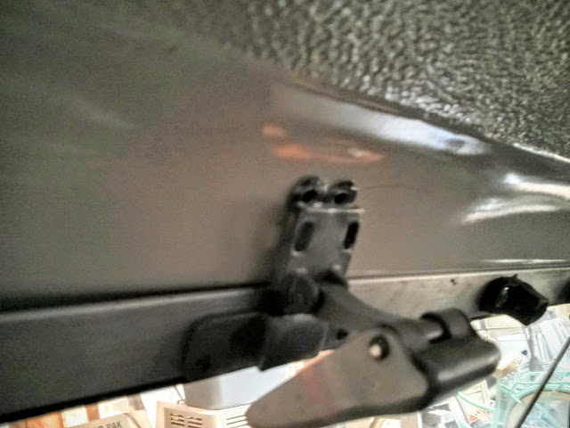

Hello All,
I just did a quick test fitting of the hinges.
they are the right distance apart and clip in correctly.
But, the whole top seems to be too far forward by a 2"+ confused smiley
the inside of the top is flush with the windshield, but the front sicks out over 2".
its almost a "sun visor" or baseball cap look.
if i need to move it back, i will need to make longer hinge extenders.
please share some pictures of the top to the windshield alignment...
Thanks,
Y.

hello All,
The correct window seals finally arrived.
I am looking forward to test fitting these this weekend.
A few days ago, i test fitted the top and as expected i need to extend the latches.
I have not yet put on a head gasket over the windshield.
I want something thin that i can rivet to the latch...
Ideas?
Y
Wayne Burner Avatar
Chester, NH, USA   USA
I would use a small piece, as thick as the existing latch, with a thinner plate to secure the two pieces together, over the top. Match drill, and tap, or rivet, your choice.
Wayne Burner Avatar
Maybe the latch could be disassembled, and a new billet aluminum piece could be made up. I know it's a lot of work, but you would get a factory look.
