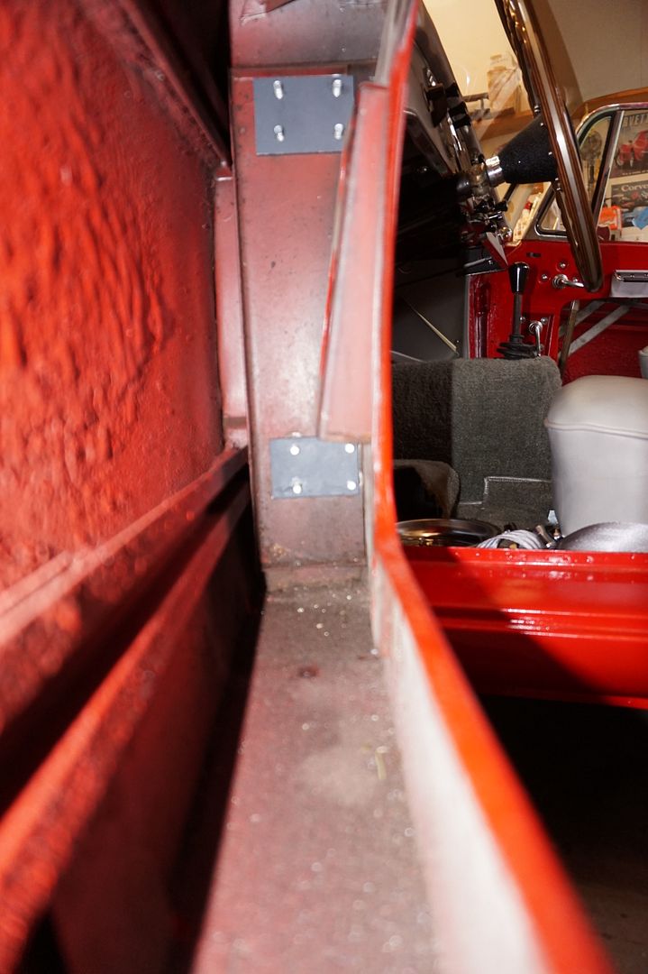

If no one has messed with the car the tapping plate will not fall out. It slides in from the inside. The hole is covered by the interior panel. It is enclosed on all other sides.
The picture shows the holes the plates slip into.
The plates if missing can be made out of 1/4” steel plate.
