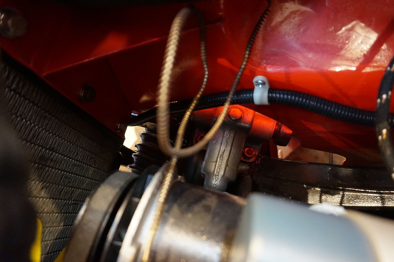

remember the goal here is no new holes and it has to be completely independent of the new wiring harness
so this goes through the grommet for the capillary pipe and is wrapped in tape and through a plastic tubing inside of the grommet
the routing through the engine compartment, using an existing hole for the bracket
wire tie to keep it nice and tight
and it pops out the front near the other looms
and where the hook up will happen

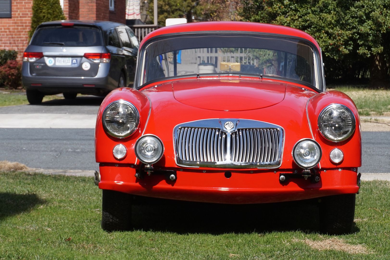

spent 90 minutes tying everything together and we have lights....i still need another feet of wire loom and to zip tie every thing nice and neat
where you have a union and connections you can use a larger section of loom to put everything in and then it gets tucked up nice and tight to the inside of the fender
and i have light its pretty awesome these puppies are pretty bright
and the switch even liiuminates when it is turned on
later today after i get the extra loom wire i will finish the job!

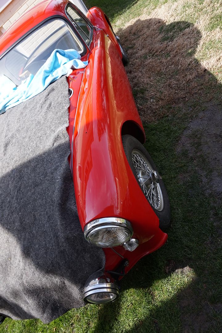

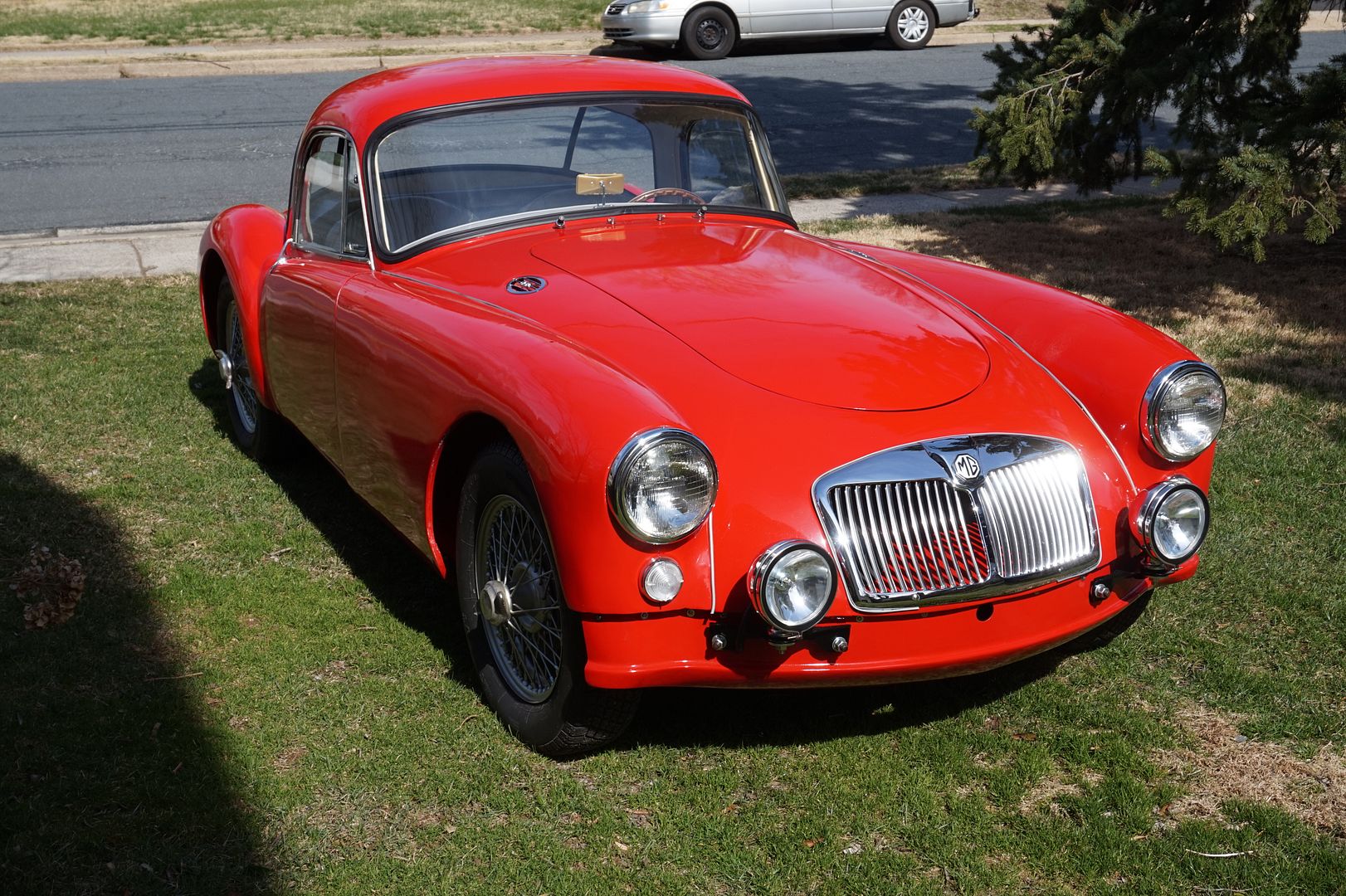

mid 40s and sunny outside , time to take the car out of hibernation.....around here a 25 minute drive is only about 5 miles. this area really sucks for classic cars
those wheel dollies really work well
heres the final finished photos of the front lights

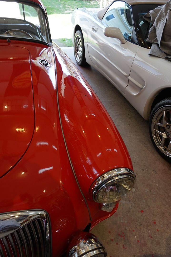

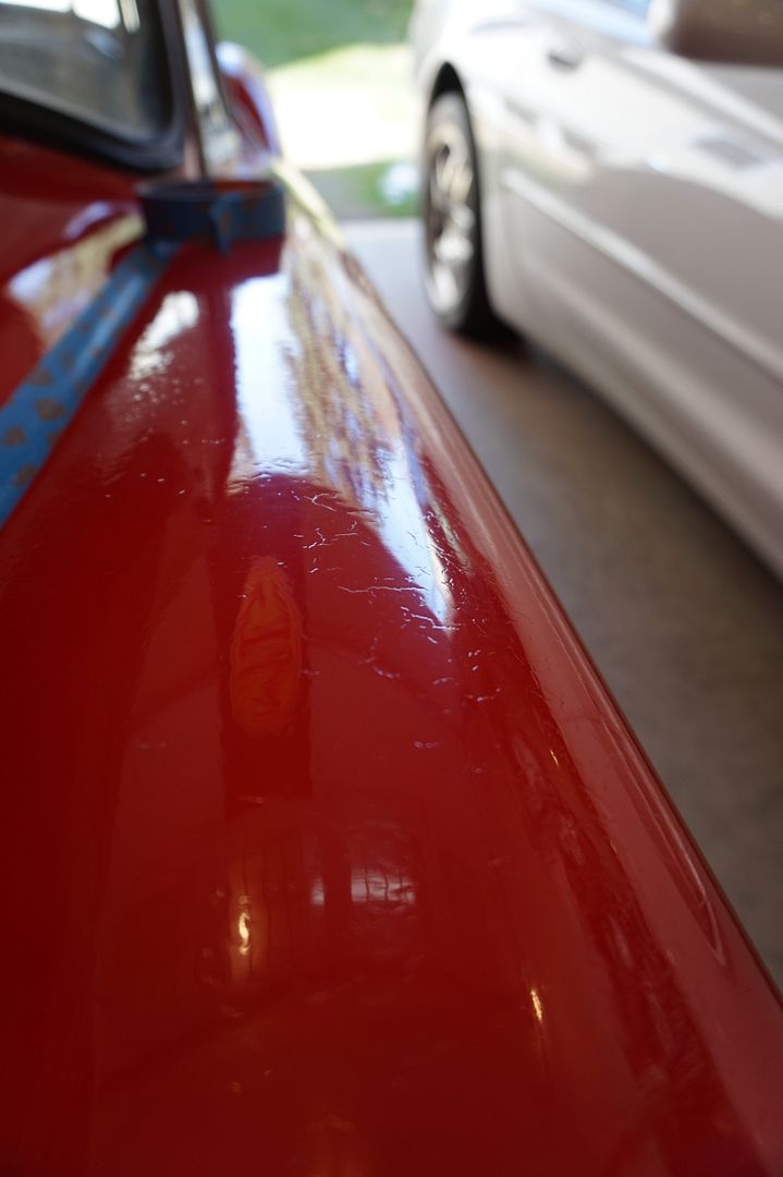

every once in a while you still have to see if you have a set of brass balls.....i wasnt happy with how the clear coat was sitting on this fender, only on this fender over time it started developing this checking as the paint/clear coat continued to dry , my supposition was i shot it too heavy and maybe there wasnt enough set up time it was only in certain spots on the fender. so i wanted to let dry for a really long time before i addressed it and today was a manhood check
i sanded it with 180, 400 and 600 grit on an electric orbital sander
then i buffed it with a wool pad
and my supposition was right...

What causes those irregularities you had to "ball-up" for?
If you haven't guessed...I'm not a painter!

this type of checking or veining can be caused by dissimilar products being applied over each other.....i am pretty anal about making sure i avoid this by using all the same products and product line. and in the 7 or 8 cars i have painted i have never had this problem so i didnt think that was the issue. remember i painted the car out side in my back yard so i had lots of things that could have screwed with me and temperature, humidity come to mind as well as the human factor of waiting for set up time and then how much paint i put down clear coat in this instance.
since the issue only happened in one spot, on one fender i was pretty sure it was an application issue. i did apply many many coats of the clear coat so i could wet sand. thats why i was able to use 180grit paper on an orbital electric sander. and i just sanded the clear coat until the checking went away. then moved up to 400 and then 600.
as Eric noted it took a lot balls to do this becasue once you started you were committed......but in any event the fender needed to be sanded to make it right and i was prepared to take it off the car and repaint it to make it right so i just dug in and lucked out
