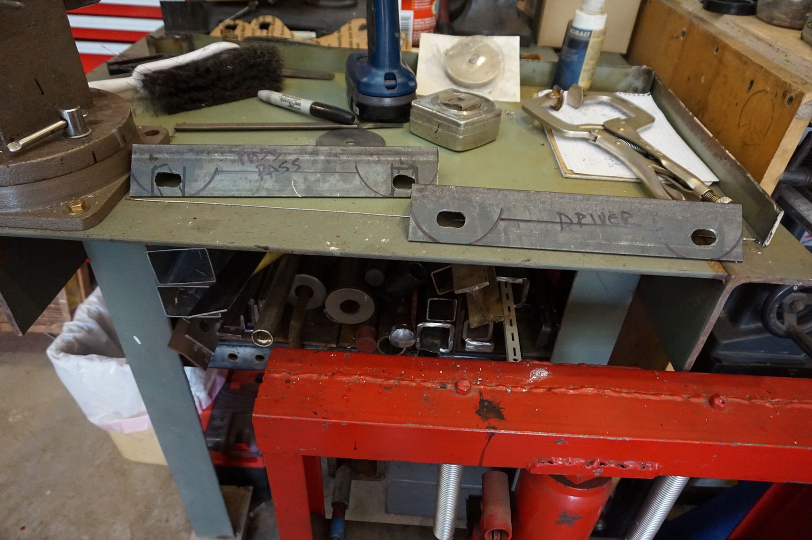

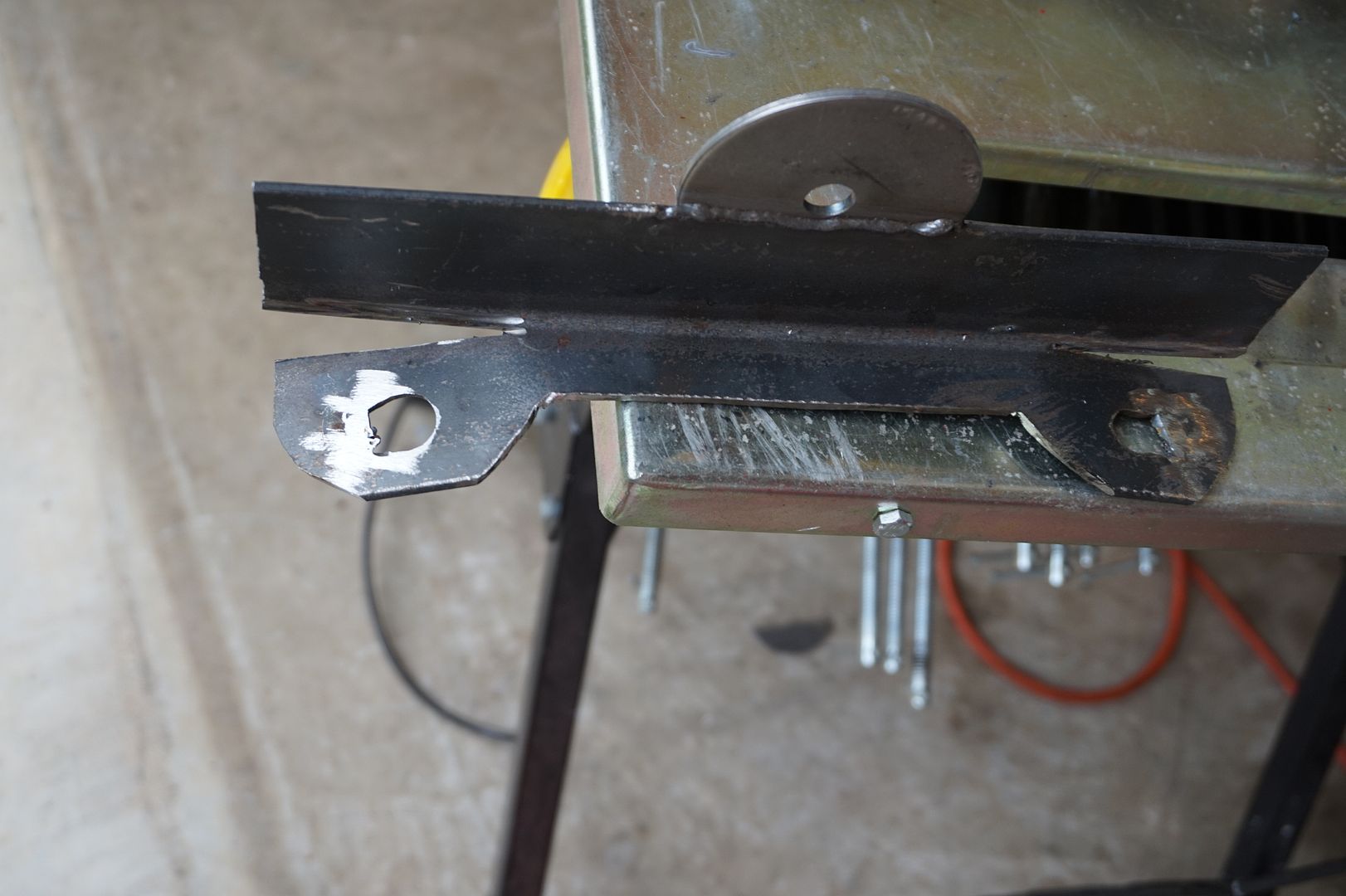

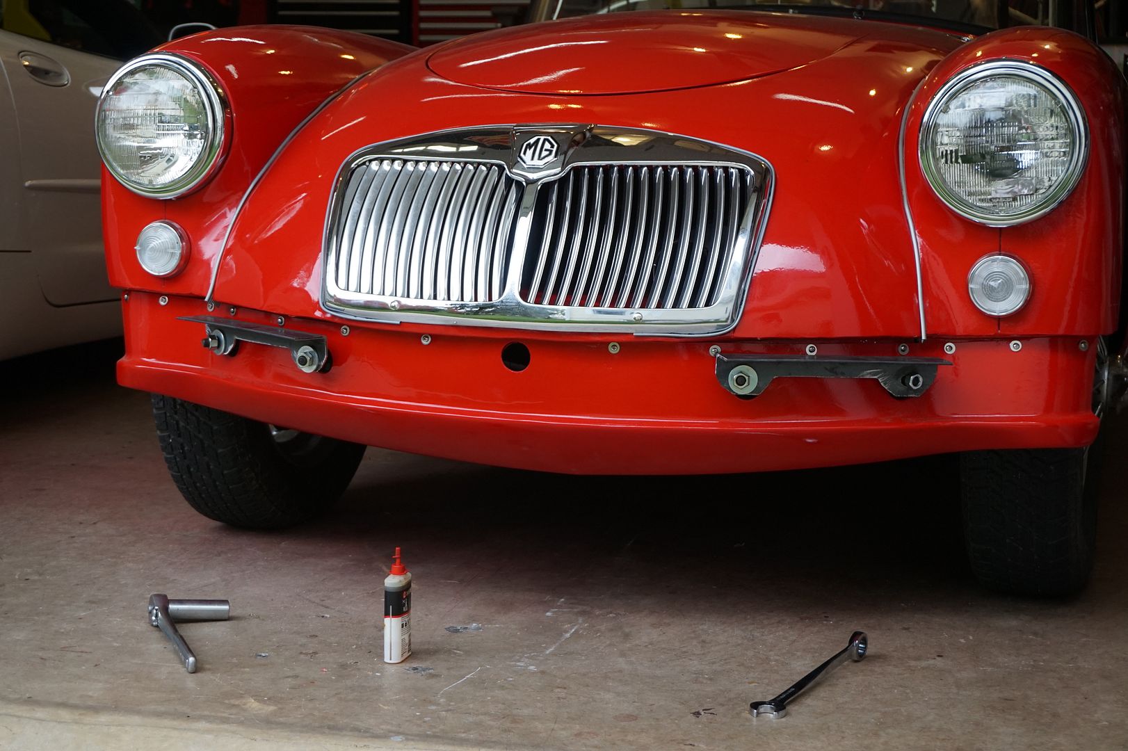

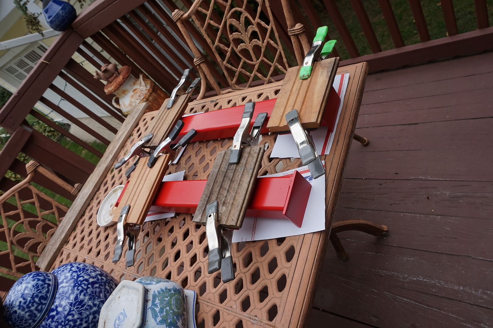

lets wrap up the cross beam adapters and glue the rubber pads to them
clamp tthem down
and a peek at a finished product

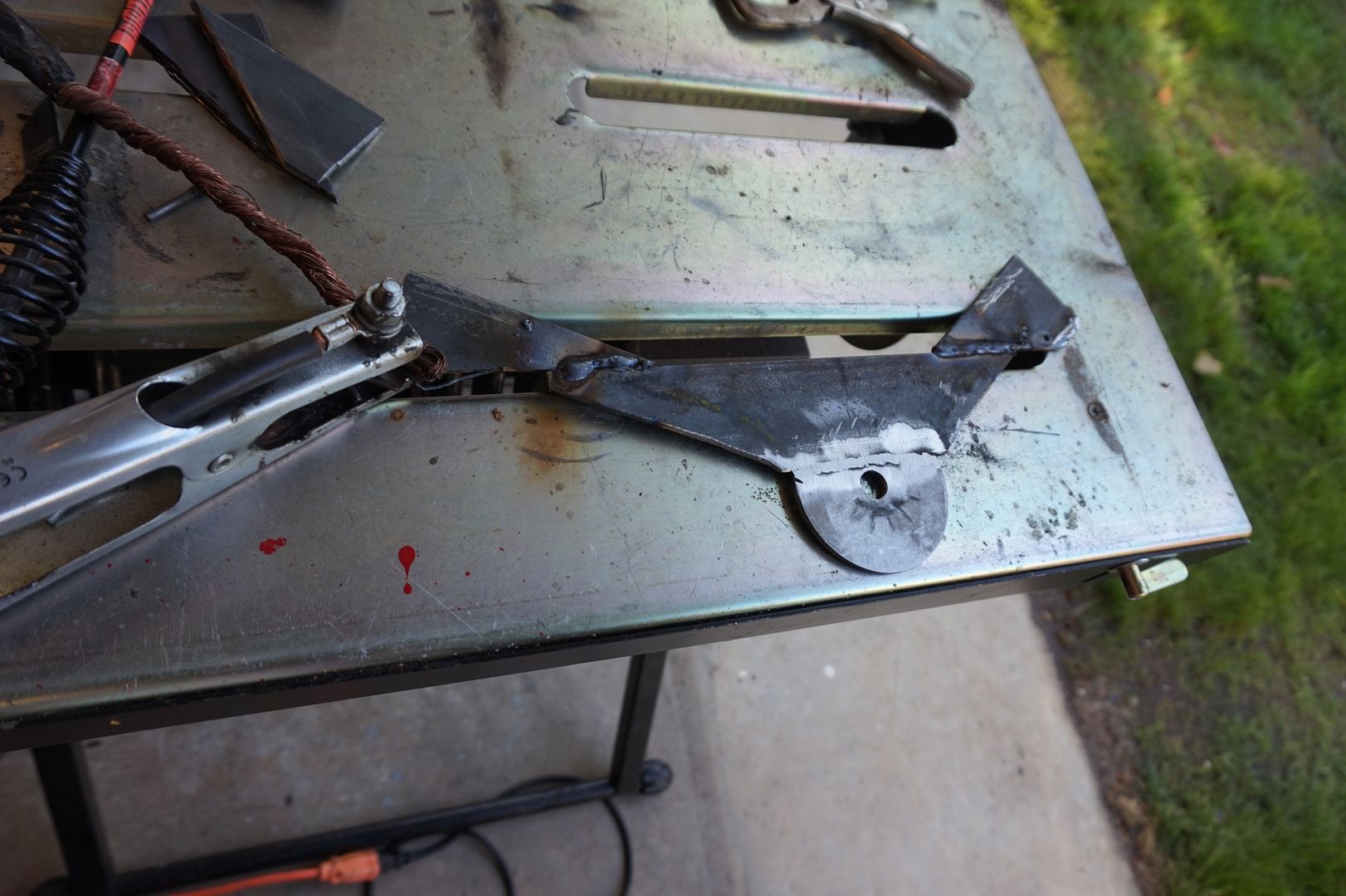

now back to the brackets

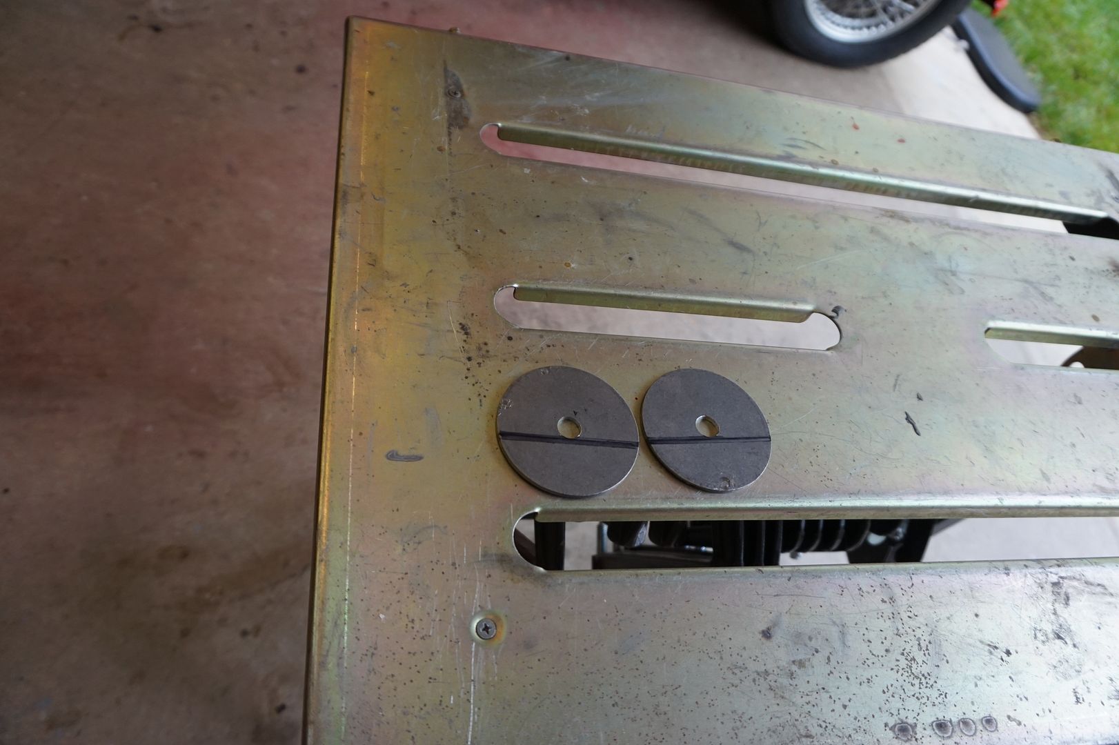

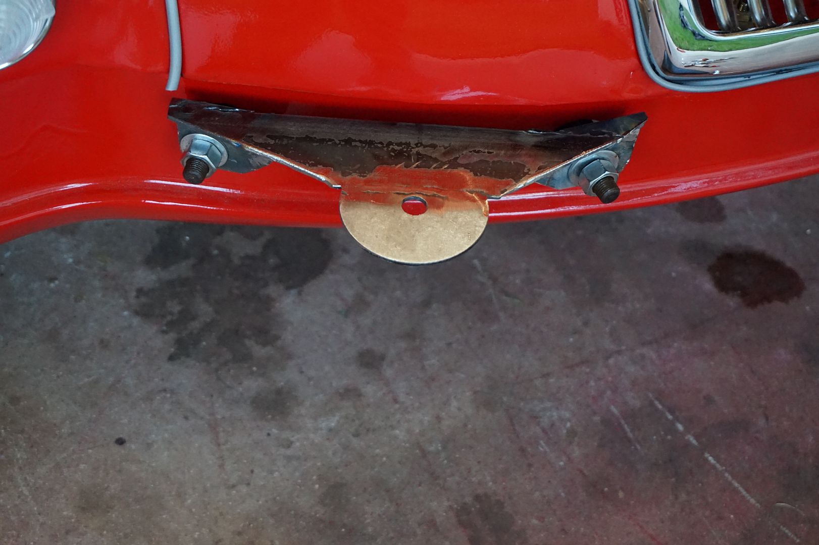

used some big round washers to give me a pattern
not a bad fit for the first time i can see i need to lower the drivers side a wee bit
now to work on the top design and determine if the brackets are curved or if they stay straight

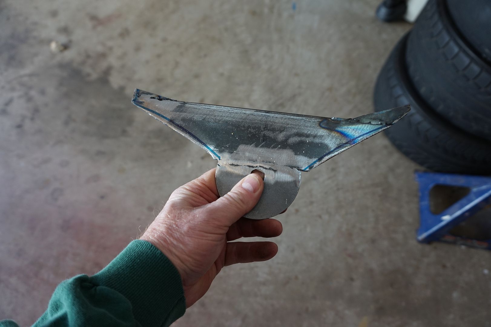

I spent another hour adjusting the brackets some and I sliced the top so the back of the angle iron would bend to fit the curve. its clear to me that the brackets in the photos i am viewing are using smaller diameter washers and the the sizing of the bracket is just slightly larger then those washers and also the top of the bracket is very tight to the bottom of the driving light mounting bracket. i have ordered the driving lights so once i get those i can figure out the top mounting spot. over all i think i am in a pretty good spot its easy to trim stuff down. and also easy to weld additional material if necesary

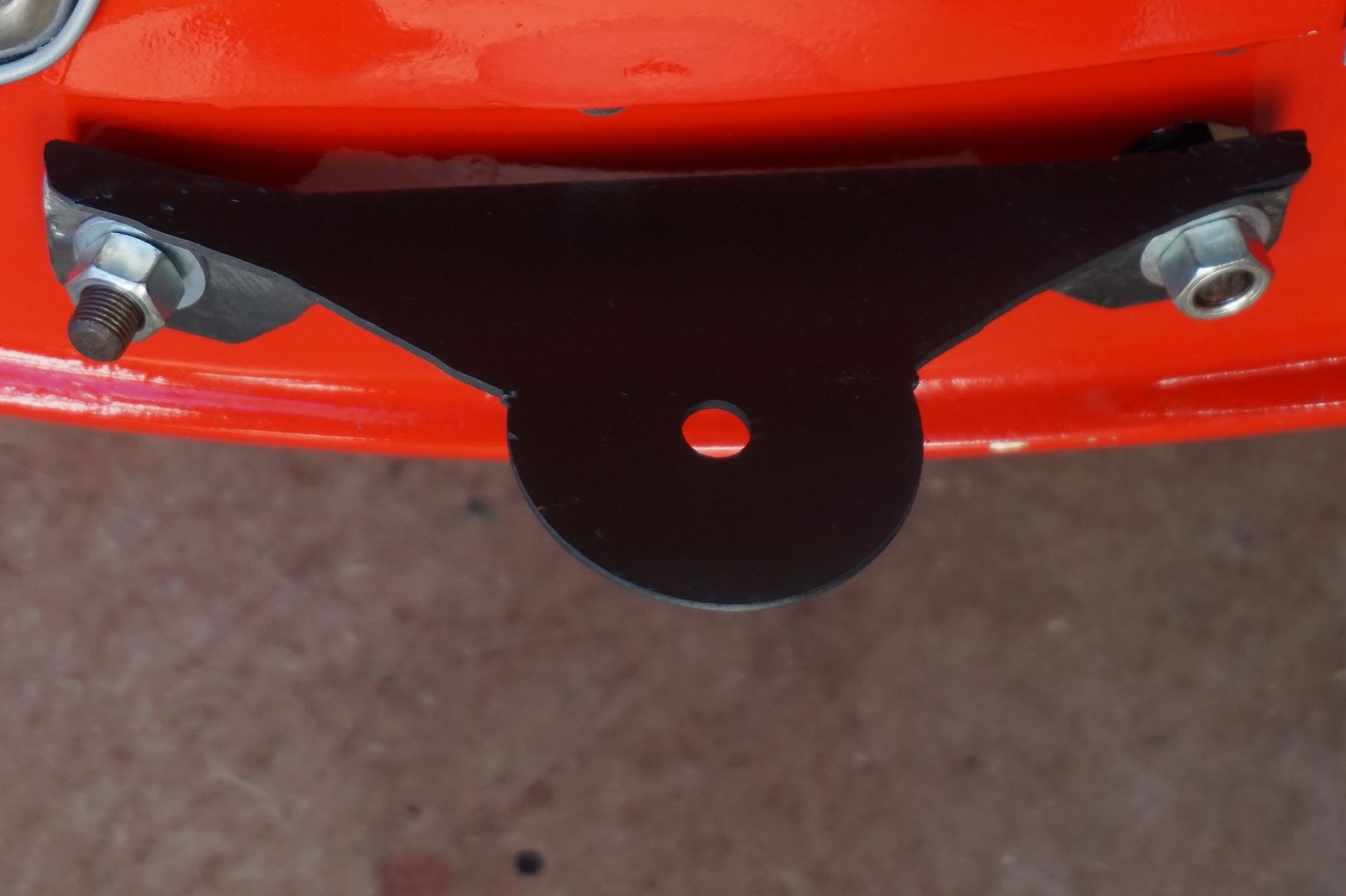

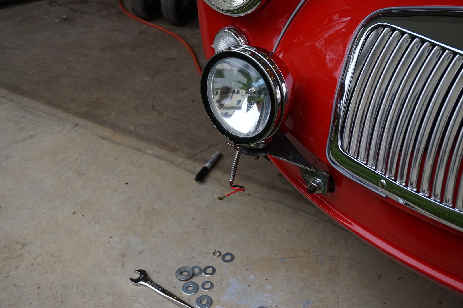

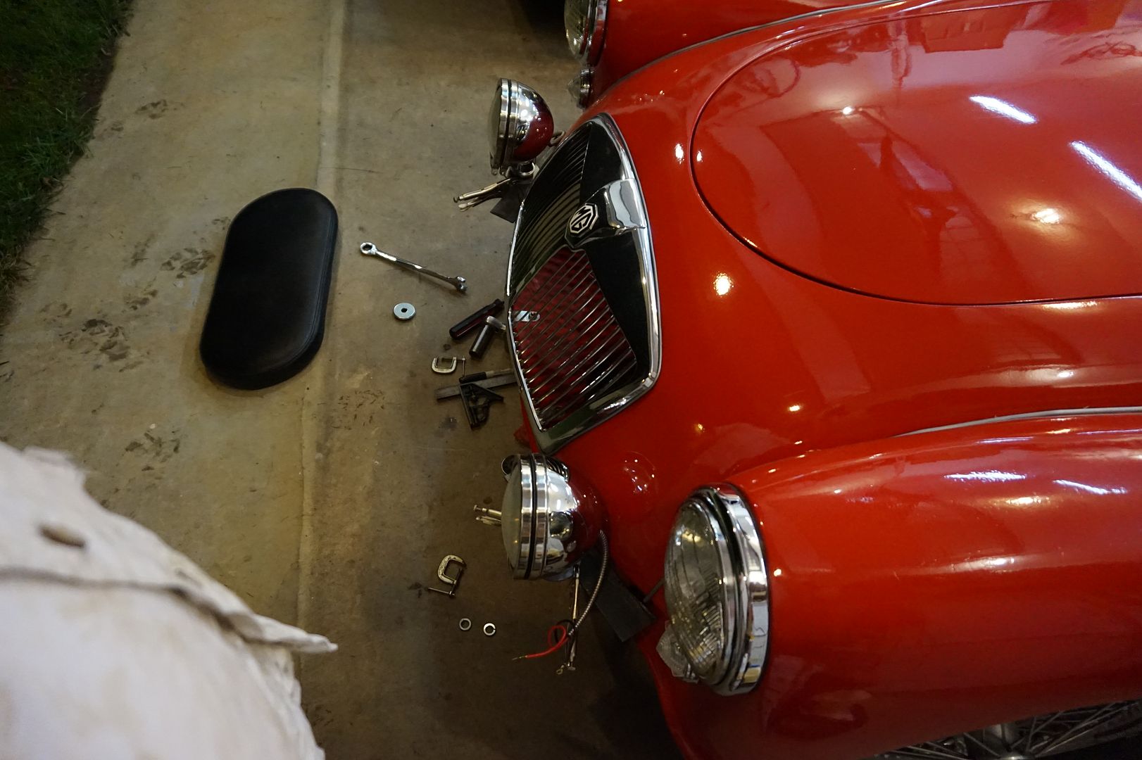

I got the lights today and mocked them up a little bit.
Edited 1 time(s). Last edit at 2017-10-12 09:03 PM by bobs77vet.

getting closer
trim up the ends for a tighter radius to the nuts

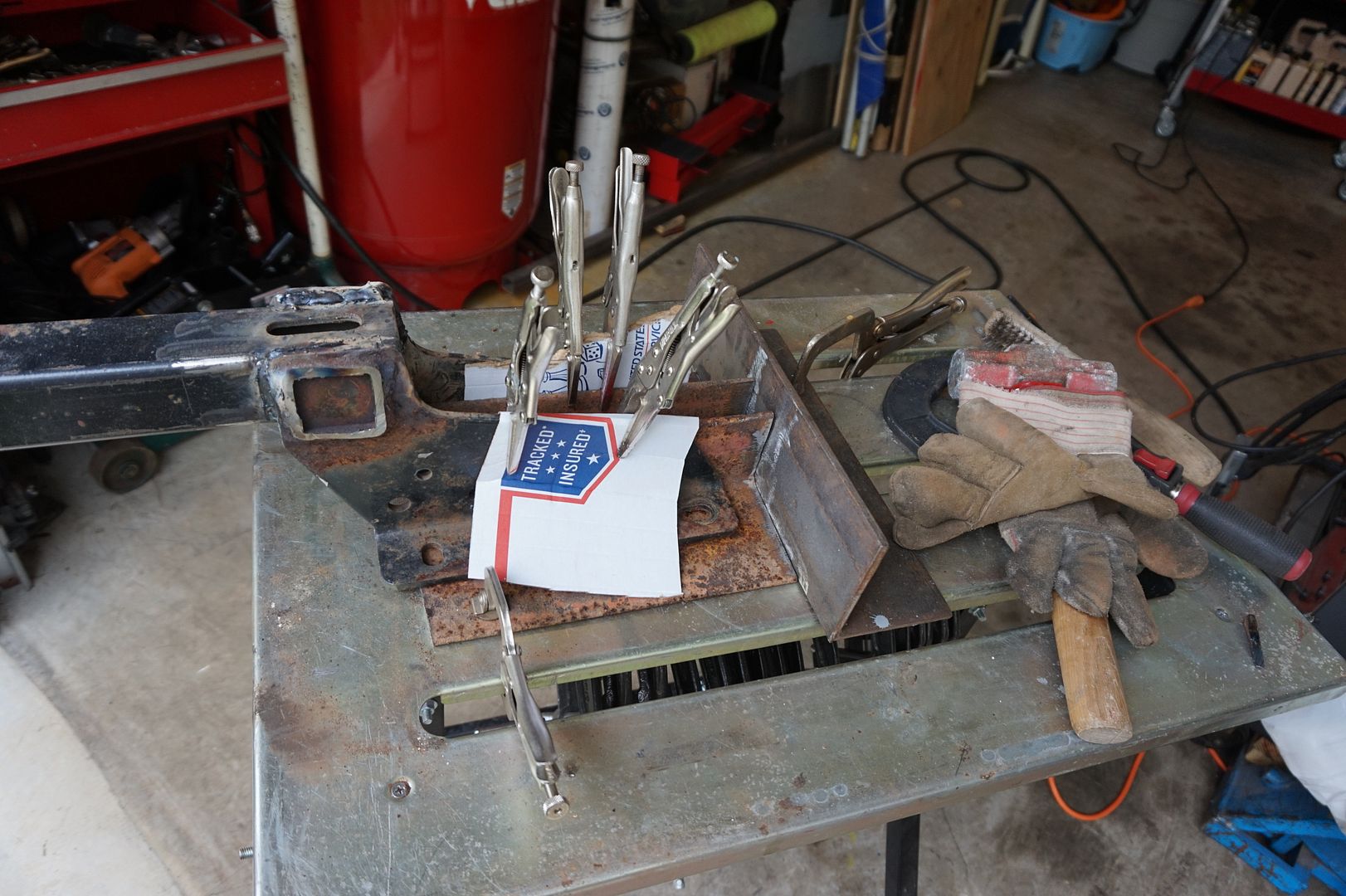

fill up the holes they were a tad too big with the smaller washer
weld it on a copper wtapped piece of 1/4 plate
trim it down

Bob, really starting to look nice. I agree with your thought that the bumper-less, driving light look is very nice. Do you plan to fill the void between the bracket top and mounting flange? I only ask as the detailing behind the light might end up being a little hazardous. Also will the brackets be painted, powder coated or chromed?

thanks, if i understand you question, yes i plan to fill the void created by bending out the back bracket that attaches to the bumper extension. so when its all done it will look like a complete L bracket.
i am thinking its going to be body color. the two pictures i have of the sebring cars one is silver and the other is body color.

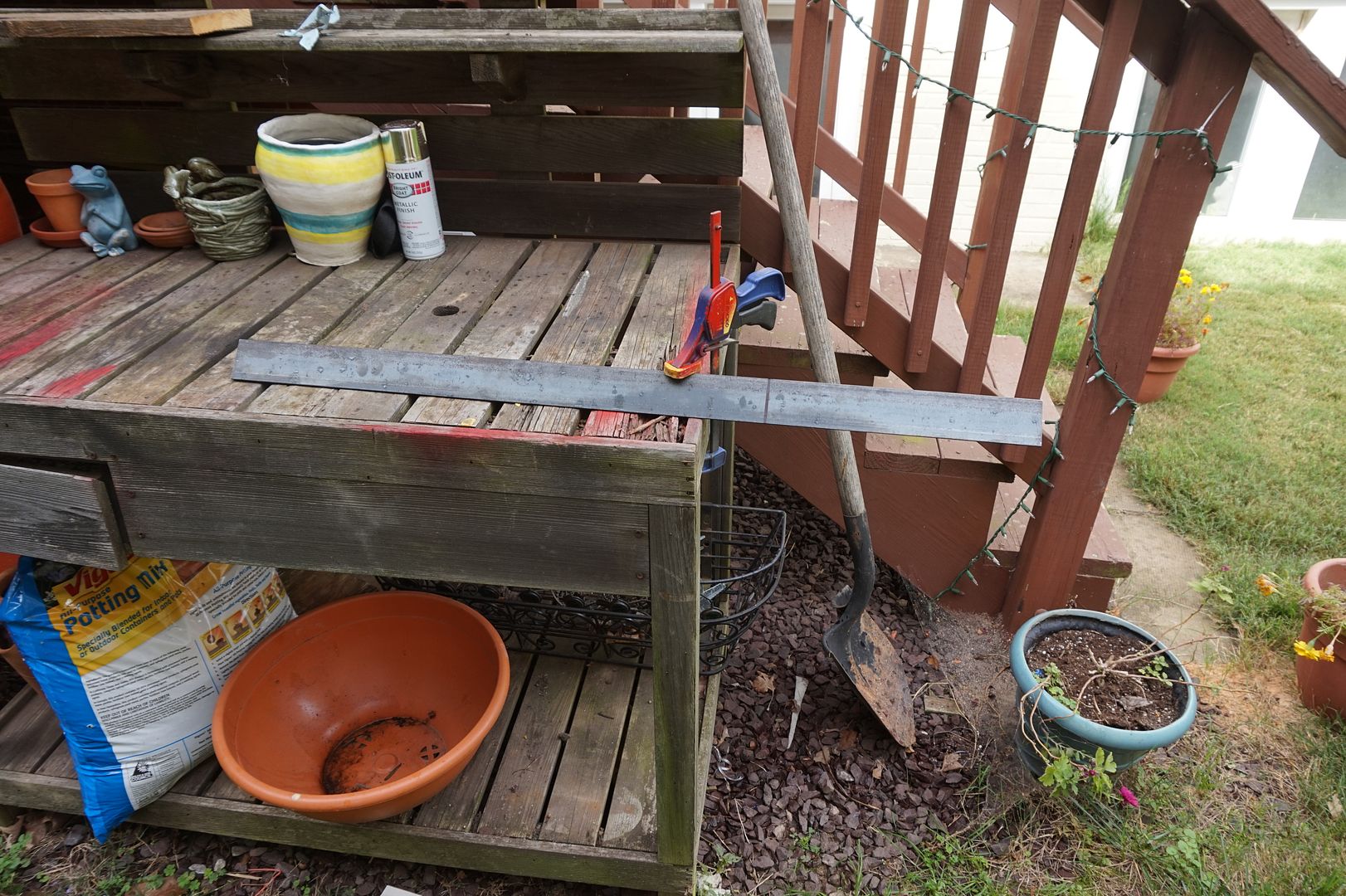

lets add some curves
lets make them symetrical
add some spray primer to see the definition of them
getting close i need to find one of my drum sanders to do some radius sanding
