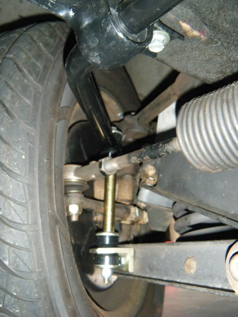

Added the ADDCO front sway bar the other day. Pretty easy install, but was not a direct bolt in as would be easy for the beginner.
Sway bar end links replace the outer lower control arm bolt, which will need to be drilled out to 3/8" to accept provided hardware. The bracket hole (outer control arm hole) need to be modified. The hole in the provided bracket is drilled center of the face, well considering the bracket is on tall enough to fit in the channel of the A-arm pice, the holes will not line up, so I had to oblong the bracket hole, or ream the A-arm hole, which would of eliminated the lower metal piece between the A-arm's.
Sway arm frame mounts- the directions say to use provided frame holes, well even with slotted mount holes I couldn't find two holes the lined up. So I bolted up the end links, little loose, and found one hole on each side that lined up with the end links vertical, and drilled and tapped one additional hole for each frame mountWell, actually, drilled and used some self tapping 5/16" bolts. BUt they worked too.
Looks good and really adds to the driving fun, not to tight, adds a little bit more stiffness to the ride, bet well worth it. Might not even need the rear bar, haven't ordered it yet but do have a stock one that I paid 10 bucks for. Will have to see what happens after she gets the 1" drop.

What diameter is that? Solid bar?

measures in at .880" inbetween 13/16 and 7/8", yes solid bar, or assuming from the weight of it.

I think you have a 7/8" bar with .005" of paint on it. 7/8 is .875. Looks good and I bet it corners real flat too.

Sway bars on those cars produced without them are a terrific idea. I had a chance to take my 75 (Addco 3/4" bar, short springs) on the track at Belleville and the pix my wife took show the car almost perfectly flat in the turns. Even the instructor was complimentary of the handling.
I also did the rear bar, which many have said isn't necessary. As I installed both at the same time, I can't help you on any difference it makes.
Duanne, I was curious about the bar brackets not bolting right up. Mine were fine, albeit the rounded brackets ADDCO provided were not the proper pieces for the squared off rubber grommets. Had to change to a strap type as the rubber bits kept slipping out to the side.

Oh boy! I just spent all day installing an Addco front sway bar on my 1976 B.
First of all, I now know what I hated about my MG. My Volvo wagon handled better that the MG did! Well, the Volvo DOES have front and rear sway barssmiling smiley But the little Brit is much much better now. It was worth the effort.
Now to the gripes. How can Addco sell a car-specific product that needs every part reworked in order to do the installation? In-frickin-furating! Both the brackets that support the bar and bushing on the frame and the l-brackets that go onto the lower control arm needed milling to fit. The instuctions that came with the bar? Un-usable! I put the bar on upside down first time; then, of course, I saw that it would never line up. A picture wouldda helped. If I had it to do again, it would take 1/4 as long but I'd be more pissed than ever about the non-fitting parts.
WHAT IS UP WITH THAT!
Well, milling on the drill press is not the most pleasant, or accurate way to do it but I got all the parts gouged out enough to fit (and I am pretty sure, still secure.) Tomorrow I am calling Addco and letting them know in the nicest possible way that they suck. Okay.
Then I took the little guy out for a spin, and for the first time since I have owned the car, I felt like I was driving the car and not the car dragging me all around the corners. What a pleasant surprise.
