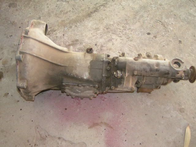

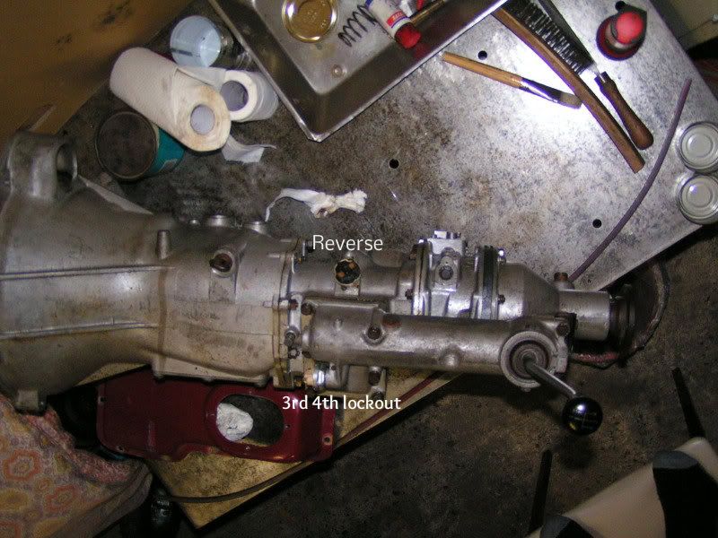

Chris,
Your picture is of a later 4 syncro transmission. The earlier 3 syncro does not have a remote. The shifter bolts directly on the transmission. And yes, some folks do heat up the shifter to mimic an earlier 3 syncro.

Nope! Wrong.

In reply to # 3908389 by sweep Not always!
In reply to # 3908384 by cunhab No OD. Look at the shift lever.
It’s not just that the shift lever is bent it’s that it is at the forward end of the trim ring.
Also on the bent shifter the part below the ball is slightly longer. It will work on an OD transmission but you’ll keep losing those little plastic bushings that go on the end.
What I’ve seen done to account for this is pushing the bushing above the little ball on the end. It helps but still leaves a sloppy shifter.

Nope! Wrong too. grinning smiley
