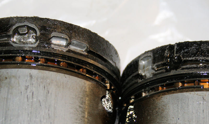

When the rings fail, piston failure follows quickly. This rod is from a late model 18V MGB.

Hey John, yep seen that a time, or two in my life, 1275s are notorious for it. This is one thing I always warn about when "re-freshening" a engine using original pistons, is folks often time will sweat the bore condition, and the piston to bore clearances, but completely ignore ring land wear, and this is what excessive ring wear can do. I have seen his in teardown just before it happen as well, when you take the piston out of the bore, the captured ring/s comes out in many pieces.

So what happened to the piston in John's picture? Did the ring break and a piece was stuck in the groove for a while, wallowing it out? How long would that have gone on, and would there have been any sign of it? Noise? Blowing oil or smoke?
Same questions on Jerald's.

I thought broken pistons (and rings) were most often caused by just slapping new rings into an irregularly worn bore?

Ring breakage can be from:
excess vertical clearance in the ring groove causing excess movement,
ring end-gap too narrow causing ring to seize in the bore when it heats up,
shock loads such as detonation,
bore taper causing excess flex cycling,
installation error, such as hammering the piston down past lack of chamfer at top of bore,
