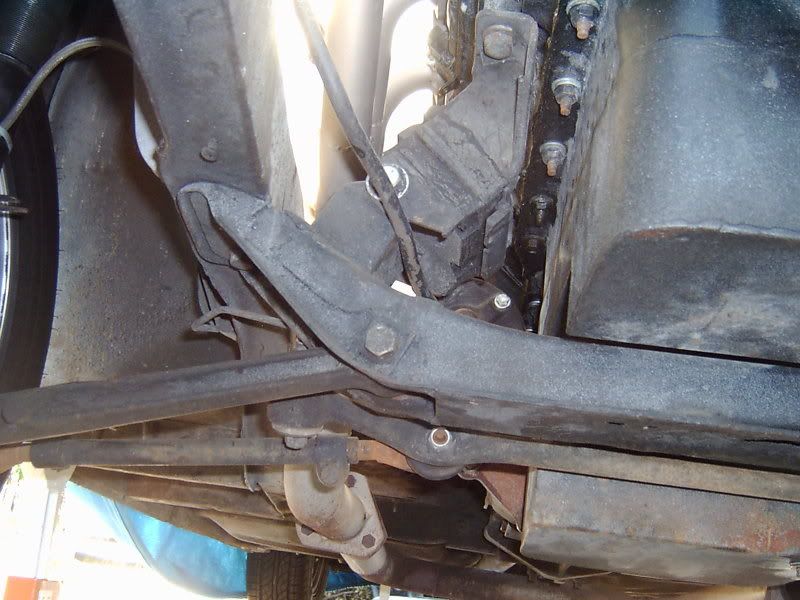

The mounts are totally new and nothing to adapt. They will insulate noise and vibration. Most of the vibration (appears to be) comes from the rear. Reason why GM used a weight on the trans to eliminate harmonic vibration. The same is done with the rear calipers.
There are different types of mounts, Biscuits type about 4 different types, different hardness.
The MGB has very little space for mounts, specially when the stock mounts are used. The stock mounts do sag in time and have to be shim. On a stock vehicle this is not a problem, in the MGB it is.
4 years ago we ( a friend and I) built one using the stock Ford mounts. 6 to 9 months later they had to be shim about 1/8" to keep the front of the pan from hitting the rack. This area only has about 1/8" clearance.
I made three sets one for my friends car, one for Rob F. did not used the factory mounts, he used Ted's front end etc.. another set for...no reason other than to have for reference. I can take some pictures of this mounts. This mounts have to be welded and used the Ford mount.
