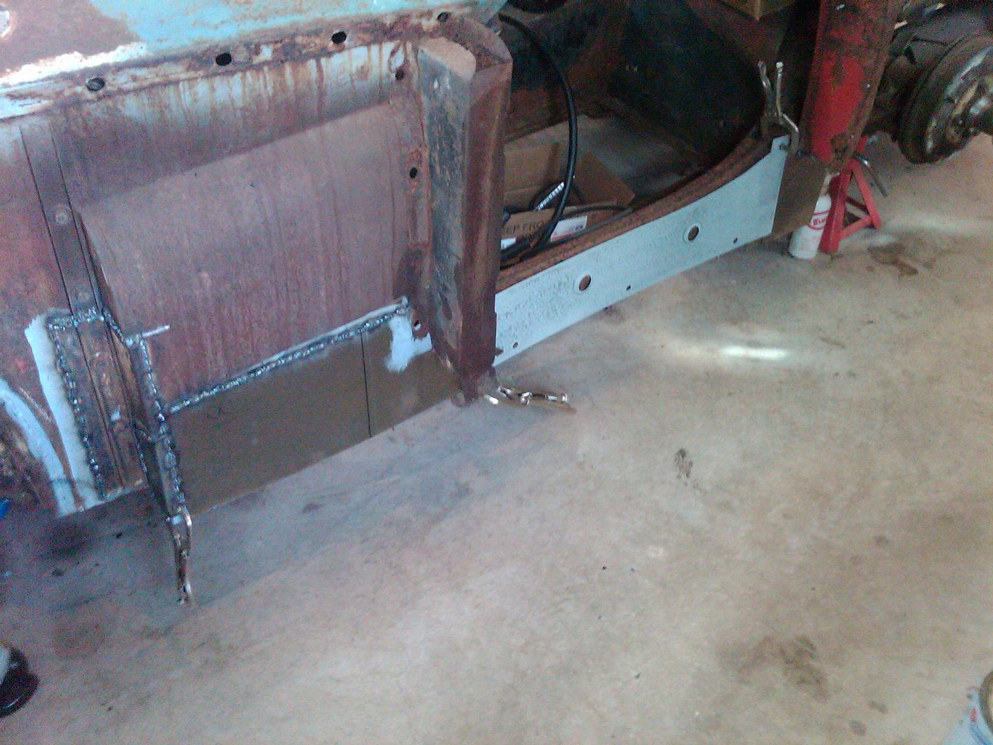

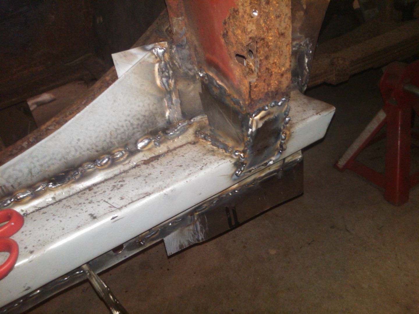

picked up my youngest son from college to day for spring break .....my goal is to have the body pulled off before he goes back to school. 4hrs working on the drivers side sill repair. i decided to start at the front and work my way back.
heres the donor panel
the salvaged repair piece
same method of grinding off the spot welds and peeling off the metal
the repaired repair panel
trimmed and primed
rough welded in place, grinding will come on another day

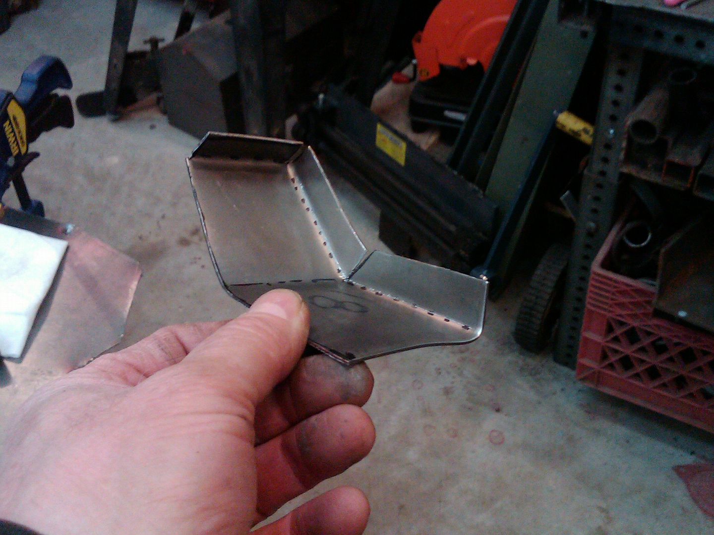

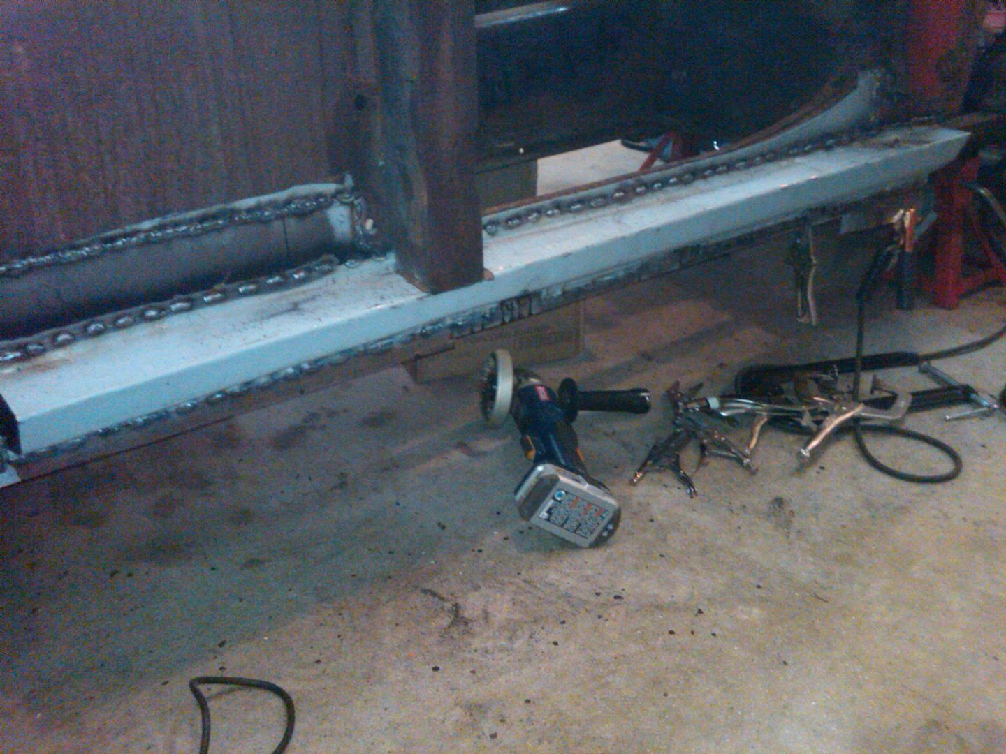

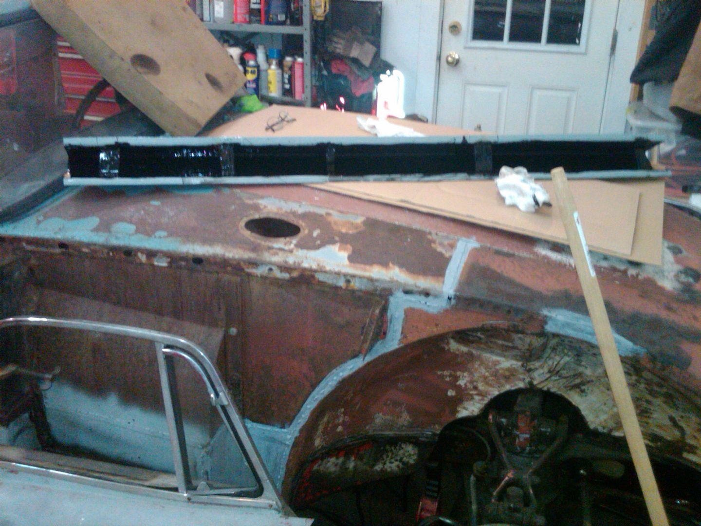

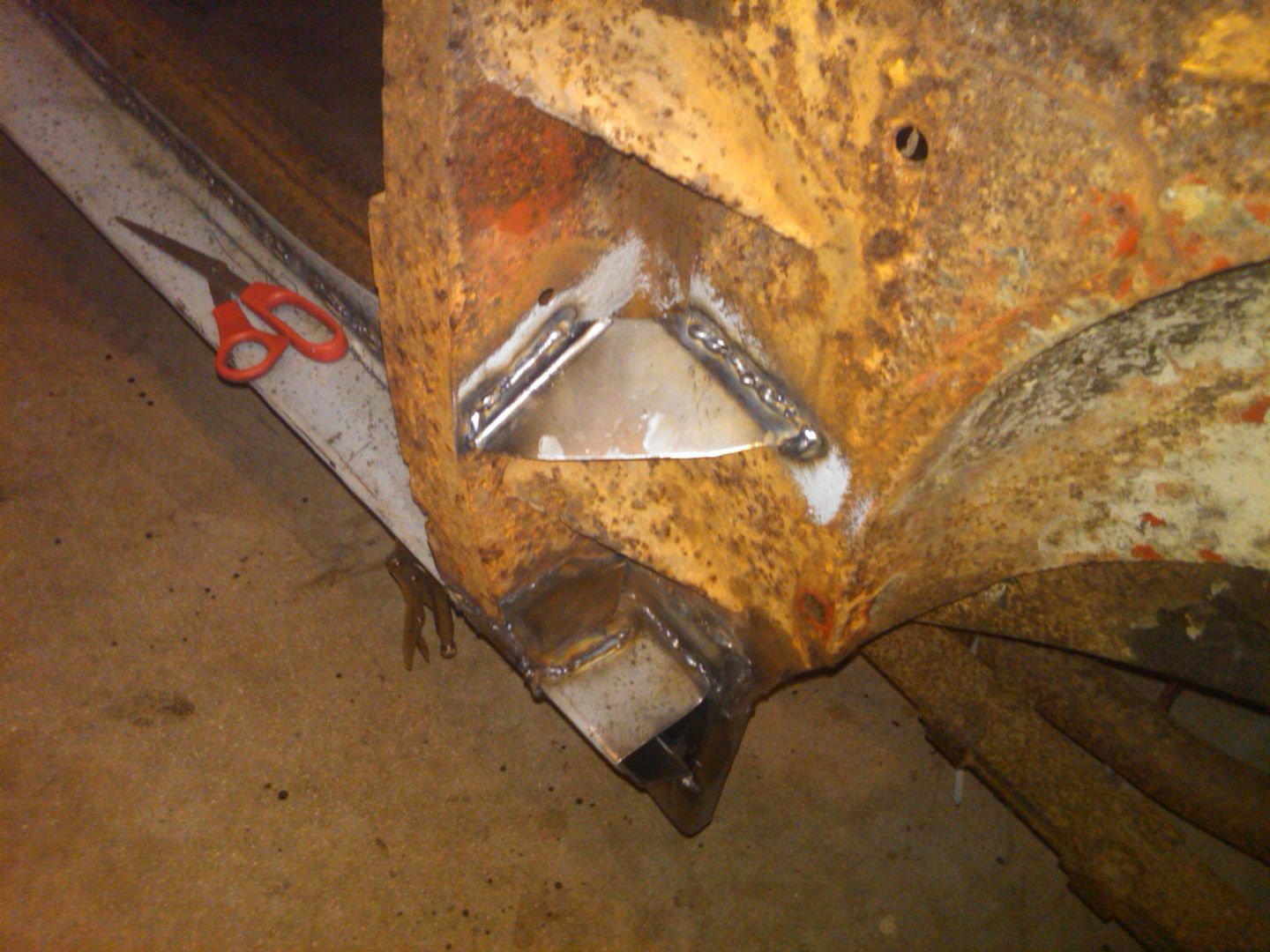

4 hrs today kicking some butt.....

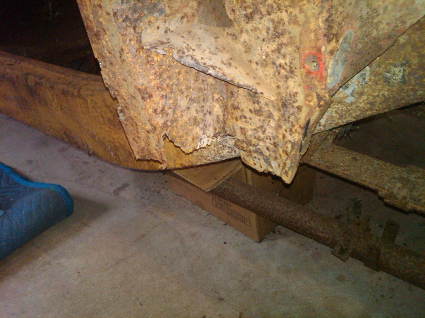

cut away the rust
the template to make the part, i am not sweating the bottom length and i am making to too long on purpose and will trim it later
this is the offset flange
here is the back side primed with cold galvanizing compound you can weld through this but it really sparks alot

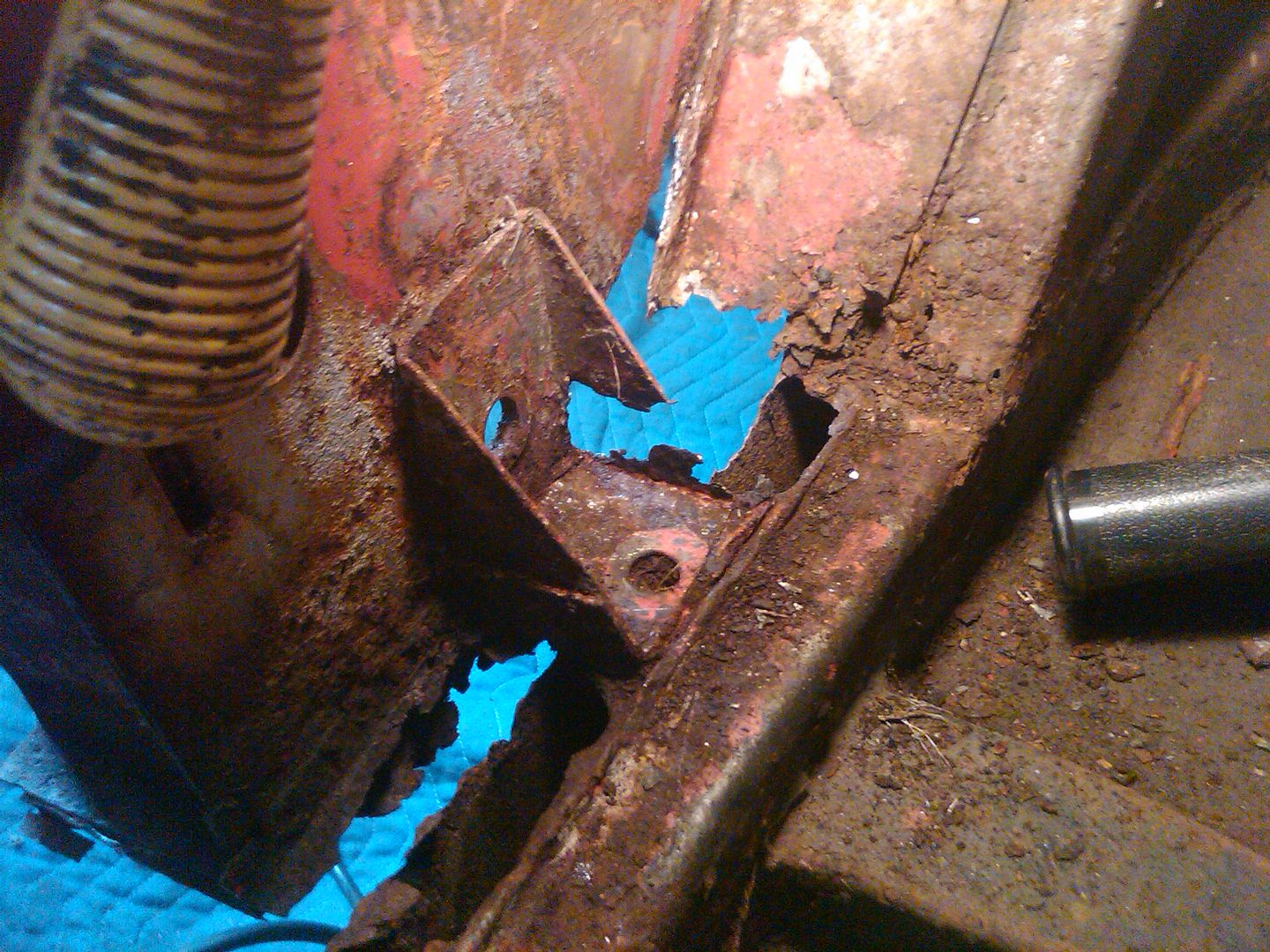

while the paint is drying i removed all the body bolts and was surprised how easily they came out and the rear body mount is in great shape

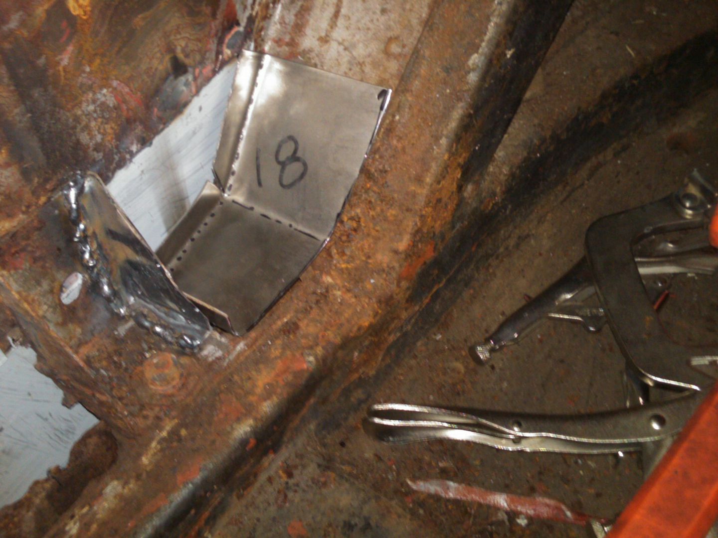

the front needs some work though
made up new piece and primed it with weld through primer

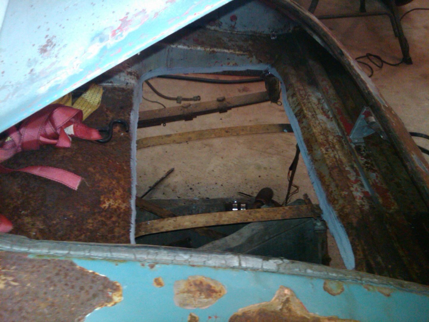

while thats drying i went ahead and removed the rusted out section
same trick i ground off the old spot welds. what looks like holes is actually shiney metal
after everything is cut away the new piece is made and flanged and primed
and welded in place one step closer to being done...

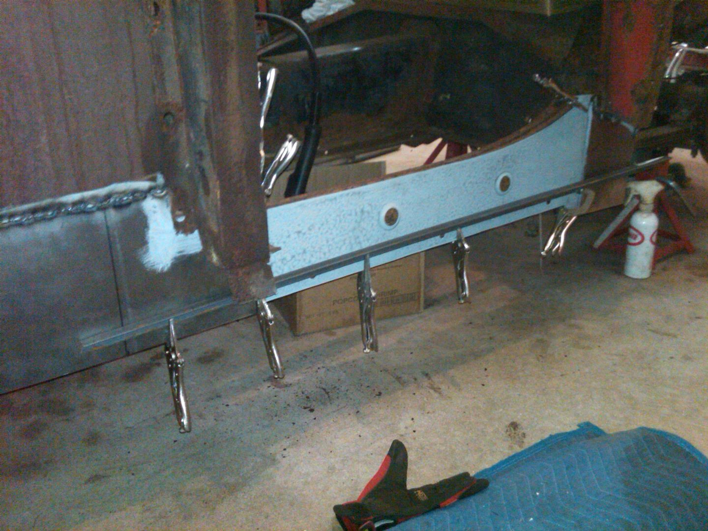

1 more hr needed to wrap things up
i used a piece of angle iron to make sure that i had a nice straight and tight seam
that thin line is the middle piece nice and straight
and of course you need to have a mock set up admittedly this was for my satisfaction
so i paint the inside of the inner sill
i had to move some stuff around to get the welding cart over behind the MGA where this use to be taking up residence... what would a garage be with out a sons custom motorcycle project??

3 more hrs of work..had my son helping me..I welded up the inner sill, while he removed the rear bumper horns and the 6 inner boot body/frame attaching bolts.one of the rear bumper horn extension bolts was a major PITA and we wound up cutting it off. i drilled two 1/8 aligning holes in the bonnet hinge mounting plate. cant believe so little work took so much time

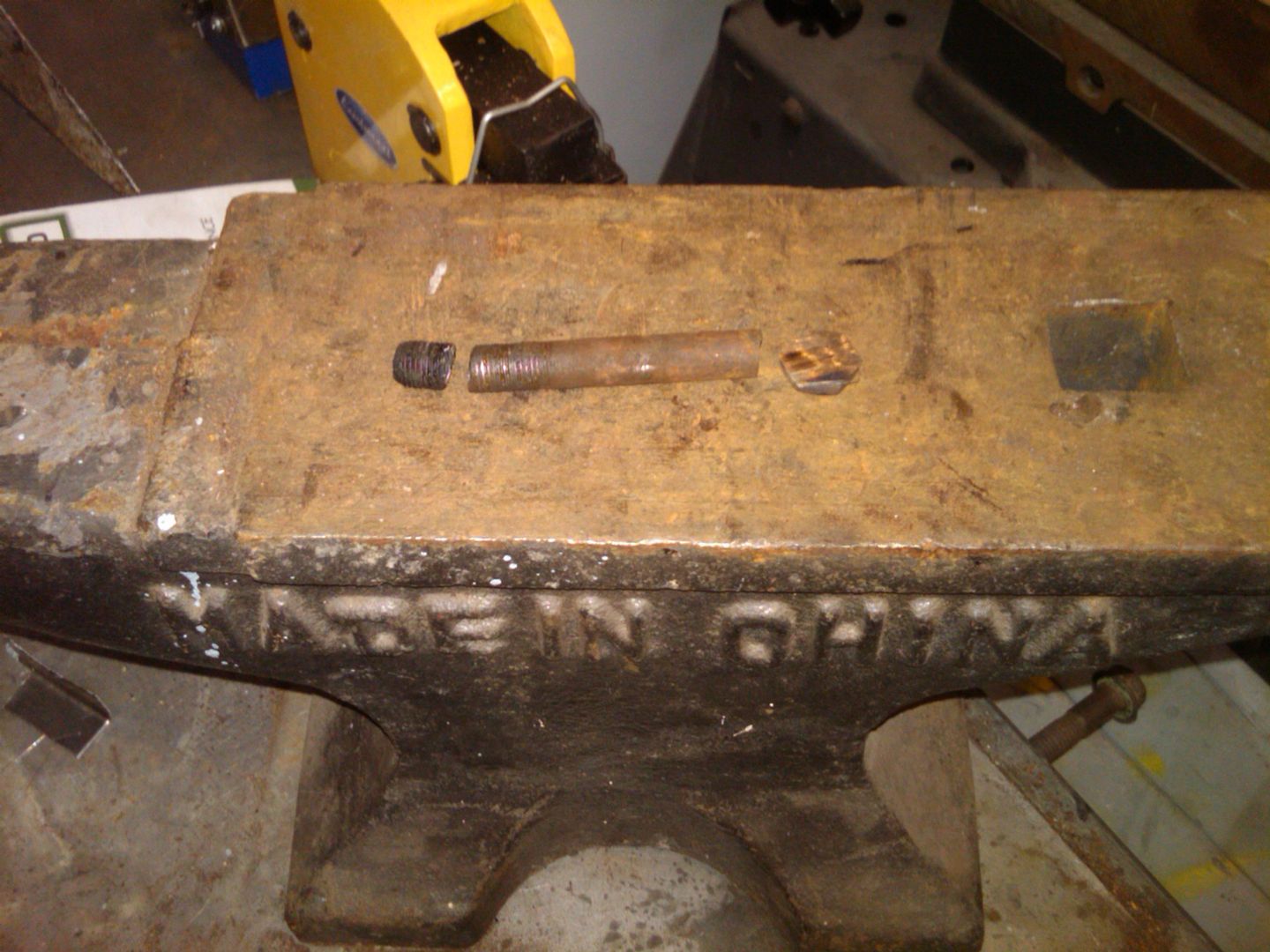

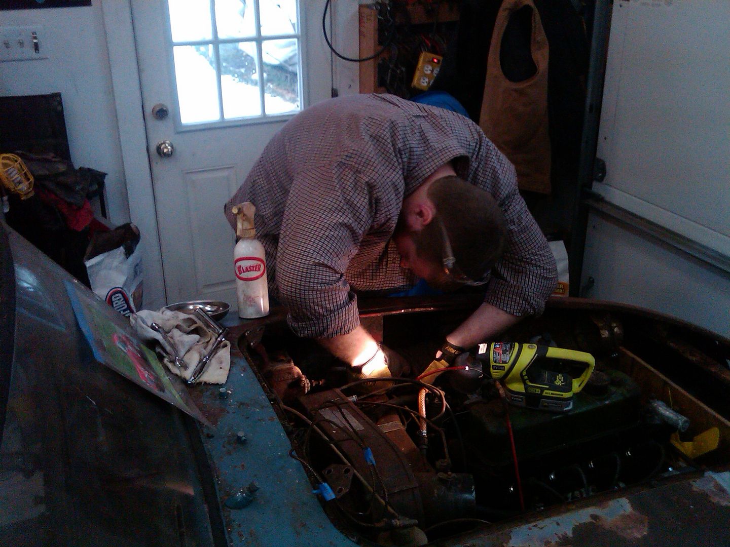

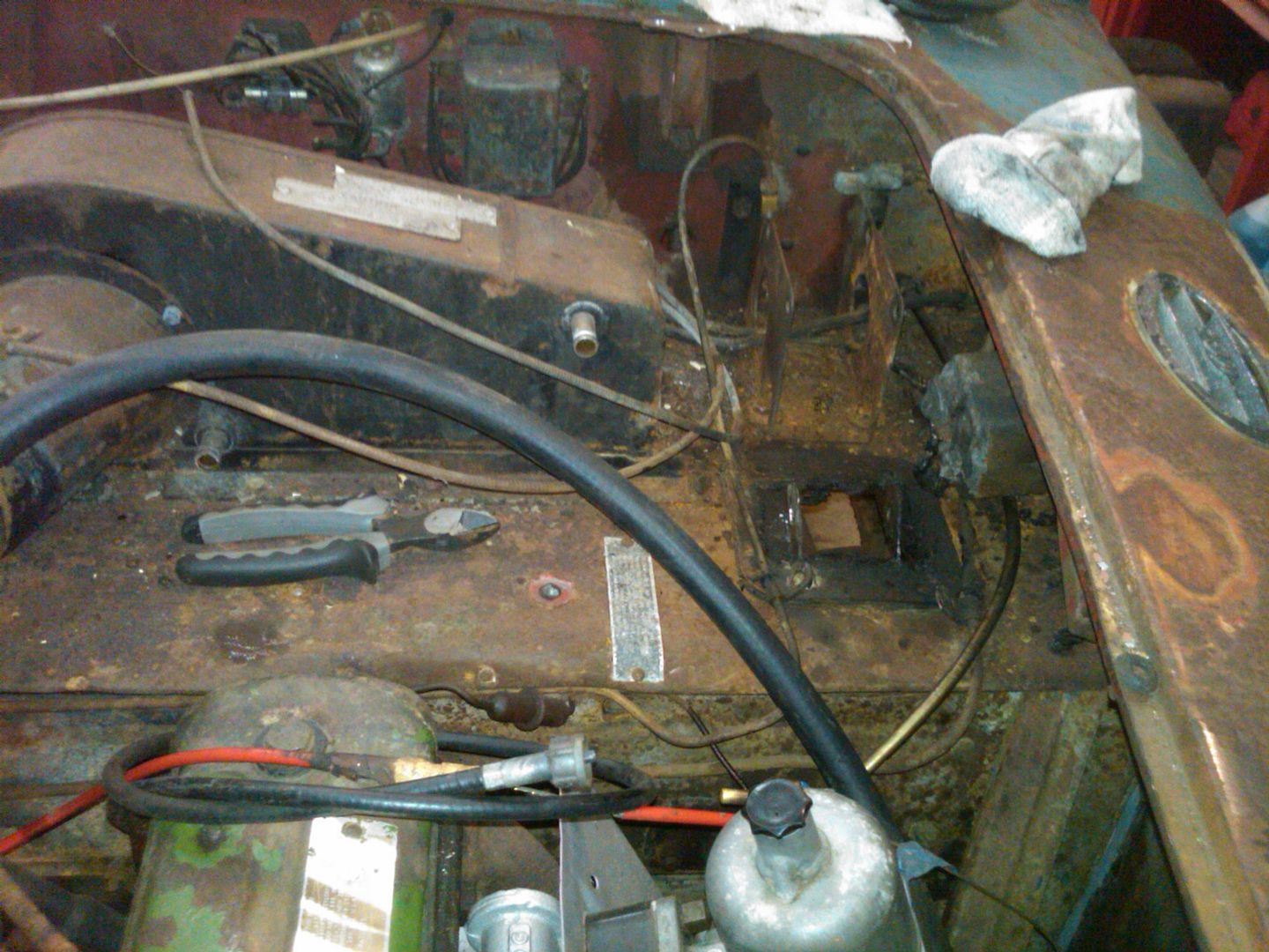

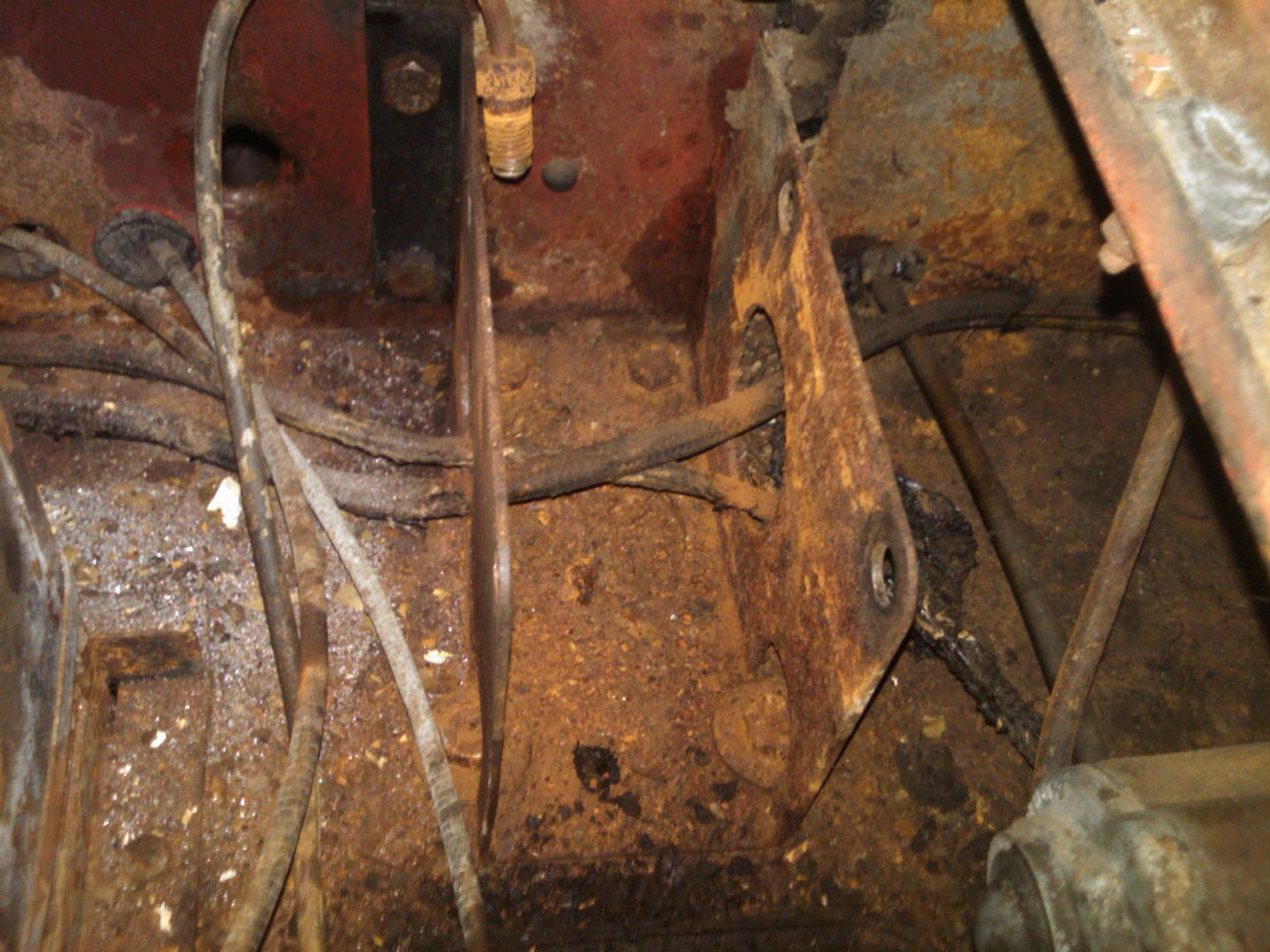

I AM WORN OUT.... little Joe and i spent another 3 hrs tackling the mechanical items that need to be taken care to remove the engine
it helps having a worker...
we are not sure hes going to fit into when its done...
not to hard removing the master cylinder
however the car gots its pound of blood from the bolt that attaches the pedal assembly to the top bracketry....the pedals swiveled on the bushings but the bolt siezed in the steel sleeve
what a PITA....i was able to manhandle it through the opening once the ends were cut off. i could only get the bolt out the sleeve when it was in the vise.

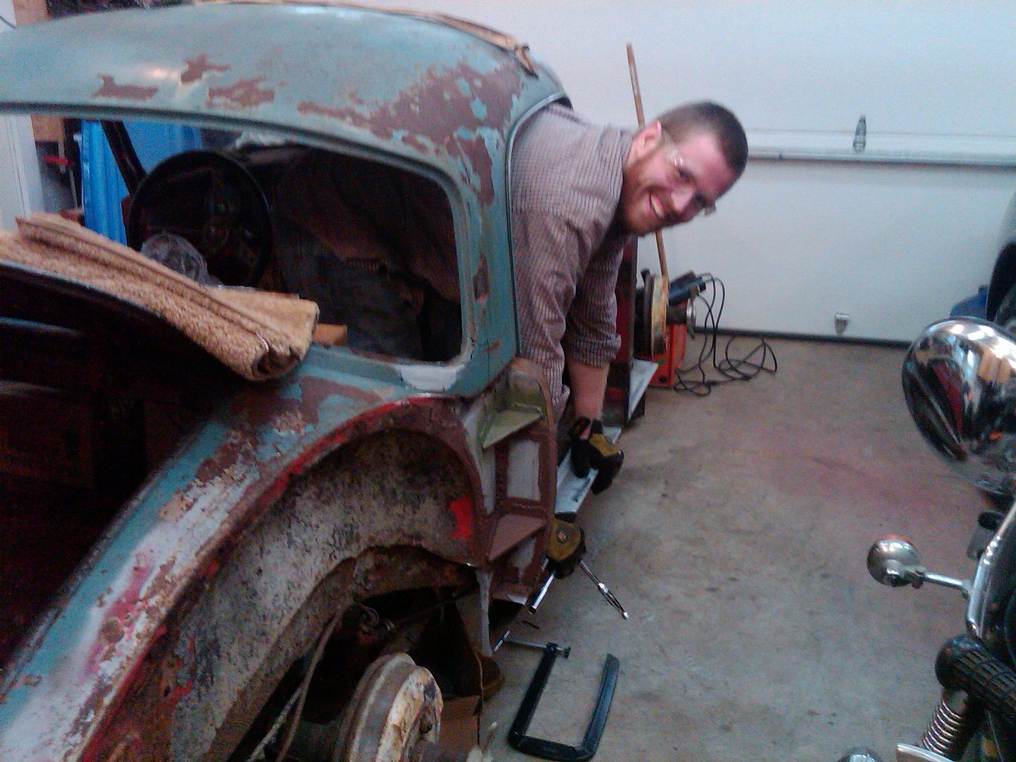

the kid smiling with his head over the side of the door is little Joe the one stuck in the door opening

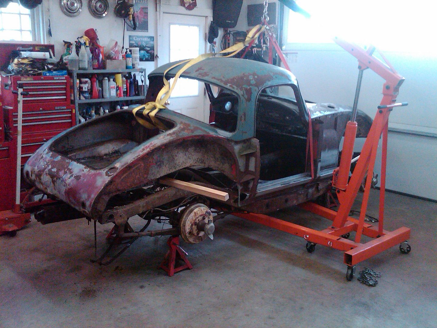

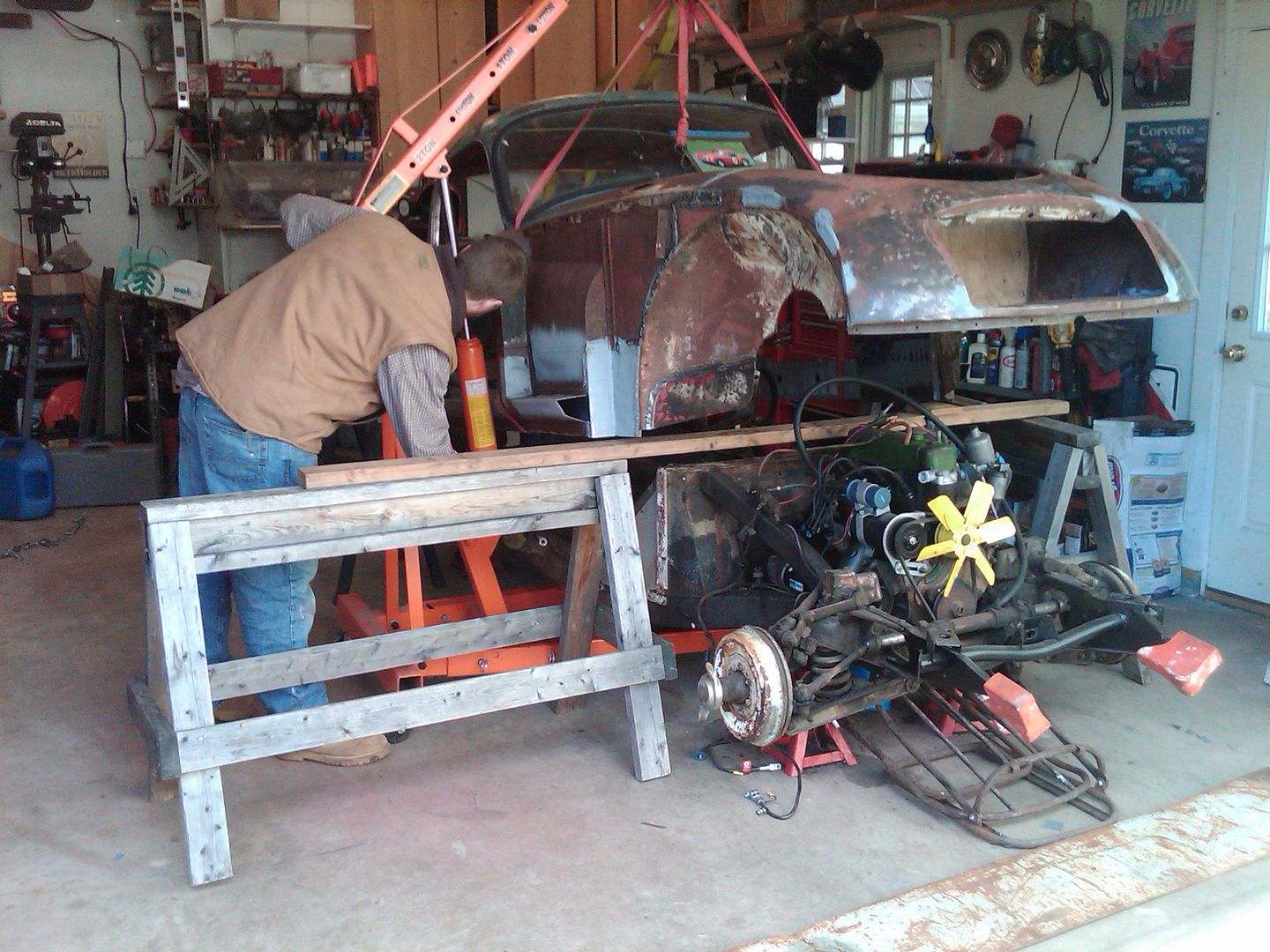

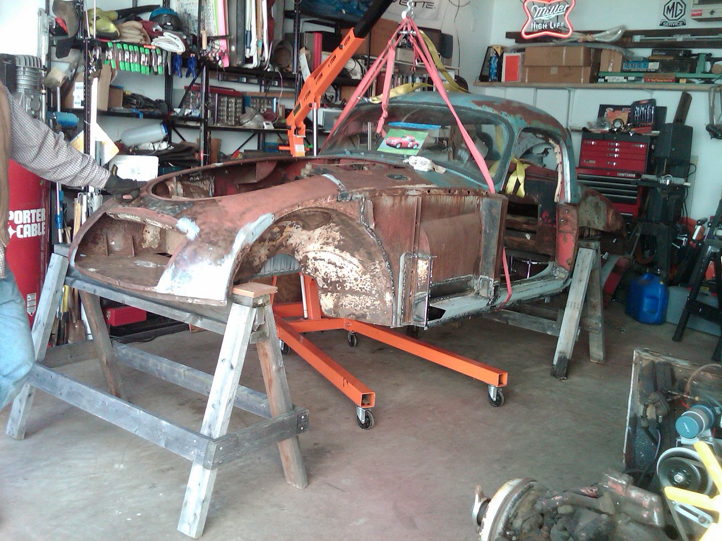

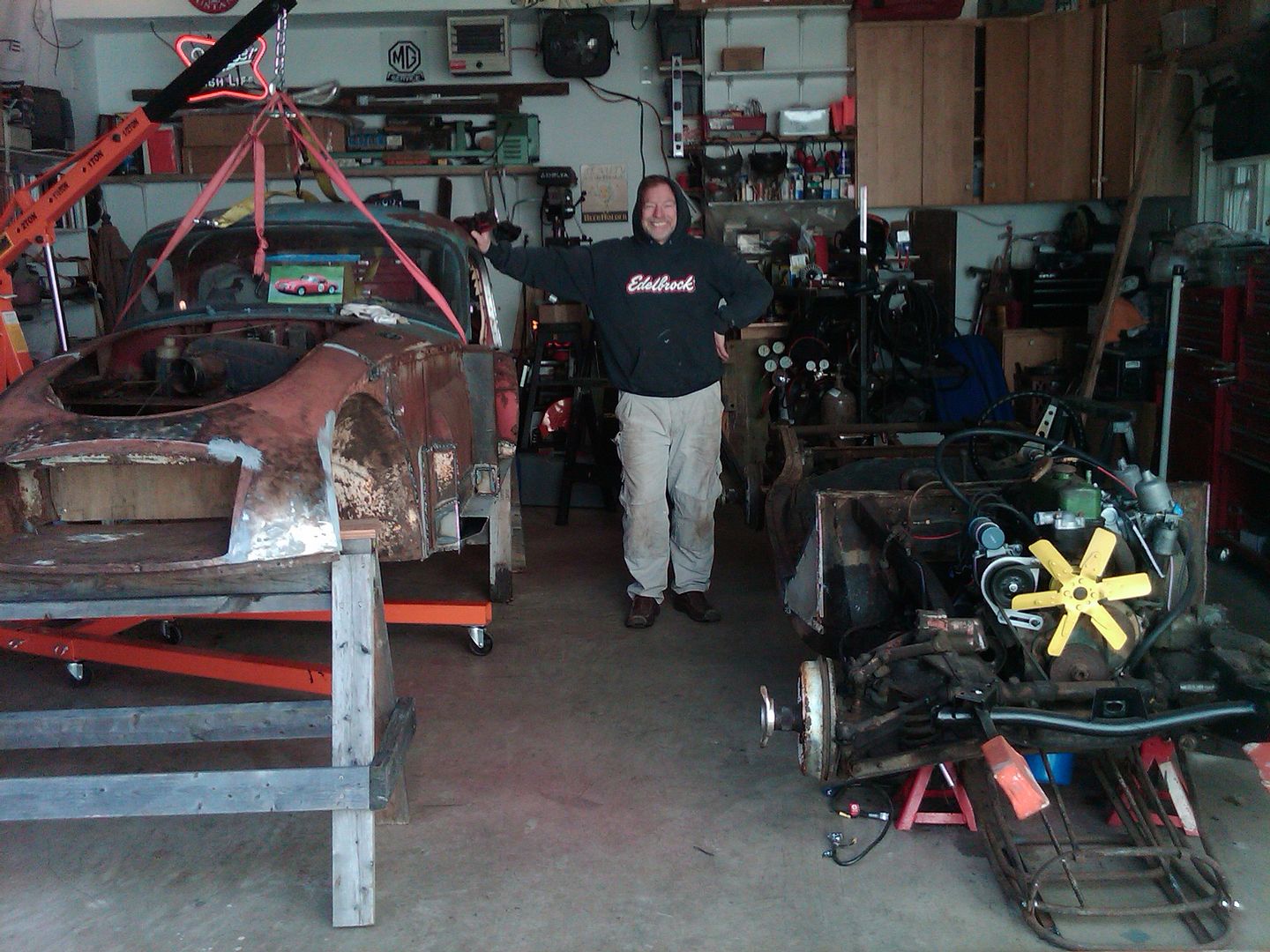

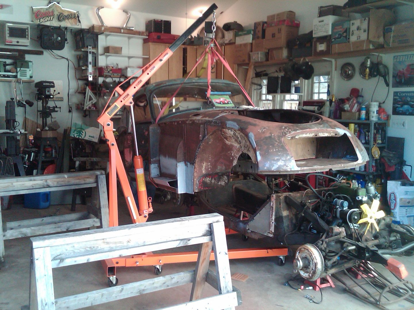

well we were getting set up to for the saturday body removal and then it happened....about 1 hours worth of work...
and this is where we realized we were almost there
yours truly
i accomplish so much more with helpers
and whamo its done
final resting spot
look dad i do fit
Edited 1 time(s). Last edit at 03/08/2013 12:35PM by bobs77vet.
