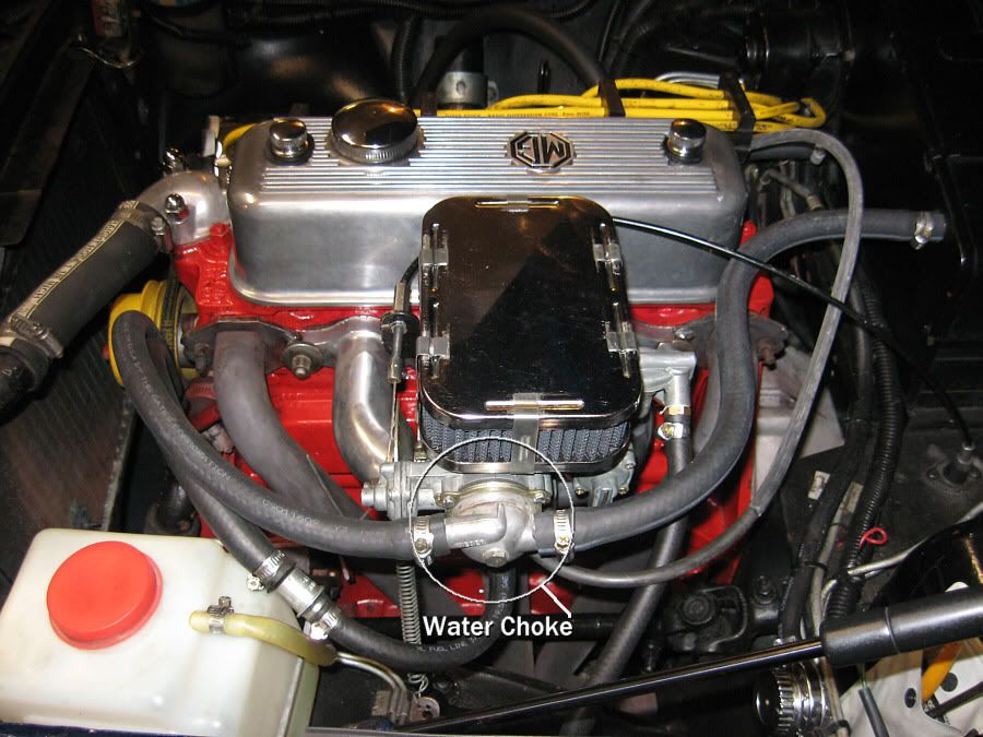

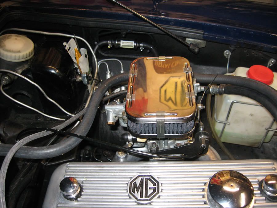

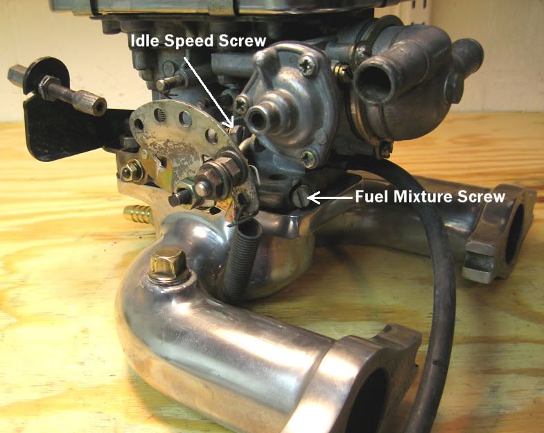

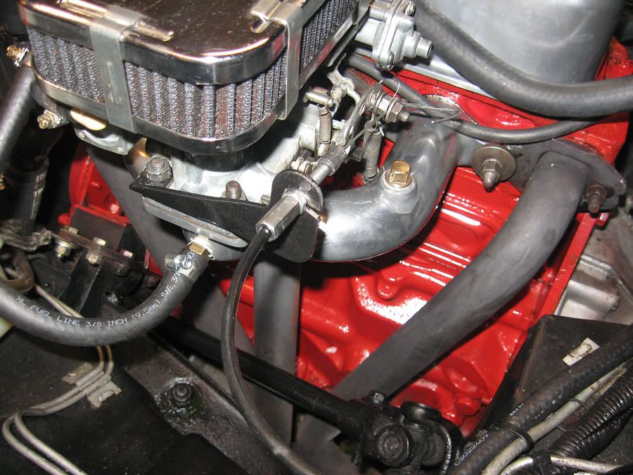

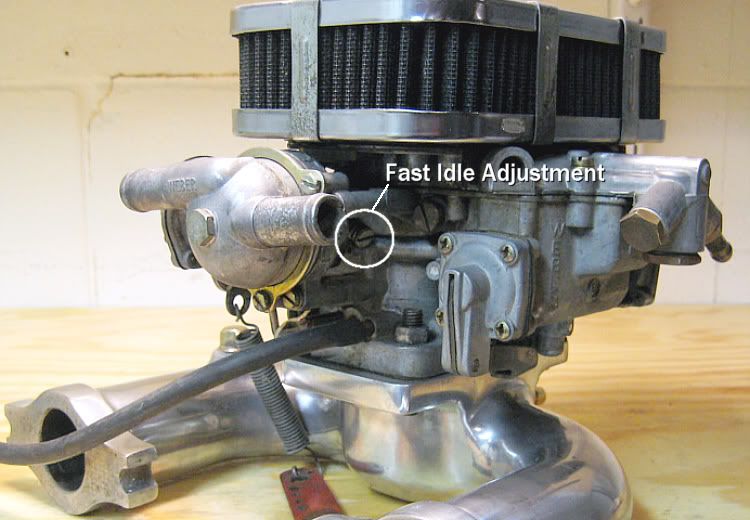

To make life much easier in the future, reverse the positioning of the carb so you can access the adjustment screws in a humane position.
before
reversed
reversed
reversed
carb in this photo is not reversed yet
